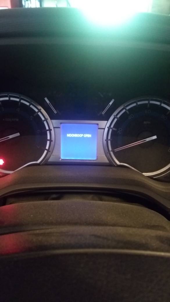

Also interesting is that the dealer said they could set it so the sunroof tilted up rather than slid open with the key, but that option isn't available on Carista. (I didn't like that option anyway, as with the sun shade shut, I wouldn't know if the sunroof was tilted open--other than the dash reminder, that is.)

There's a dash reminder for that ??? I have something new to look for! :)
With a yellow triangle flasher.
