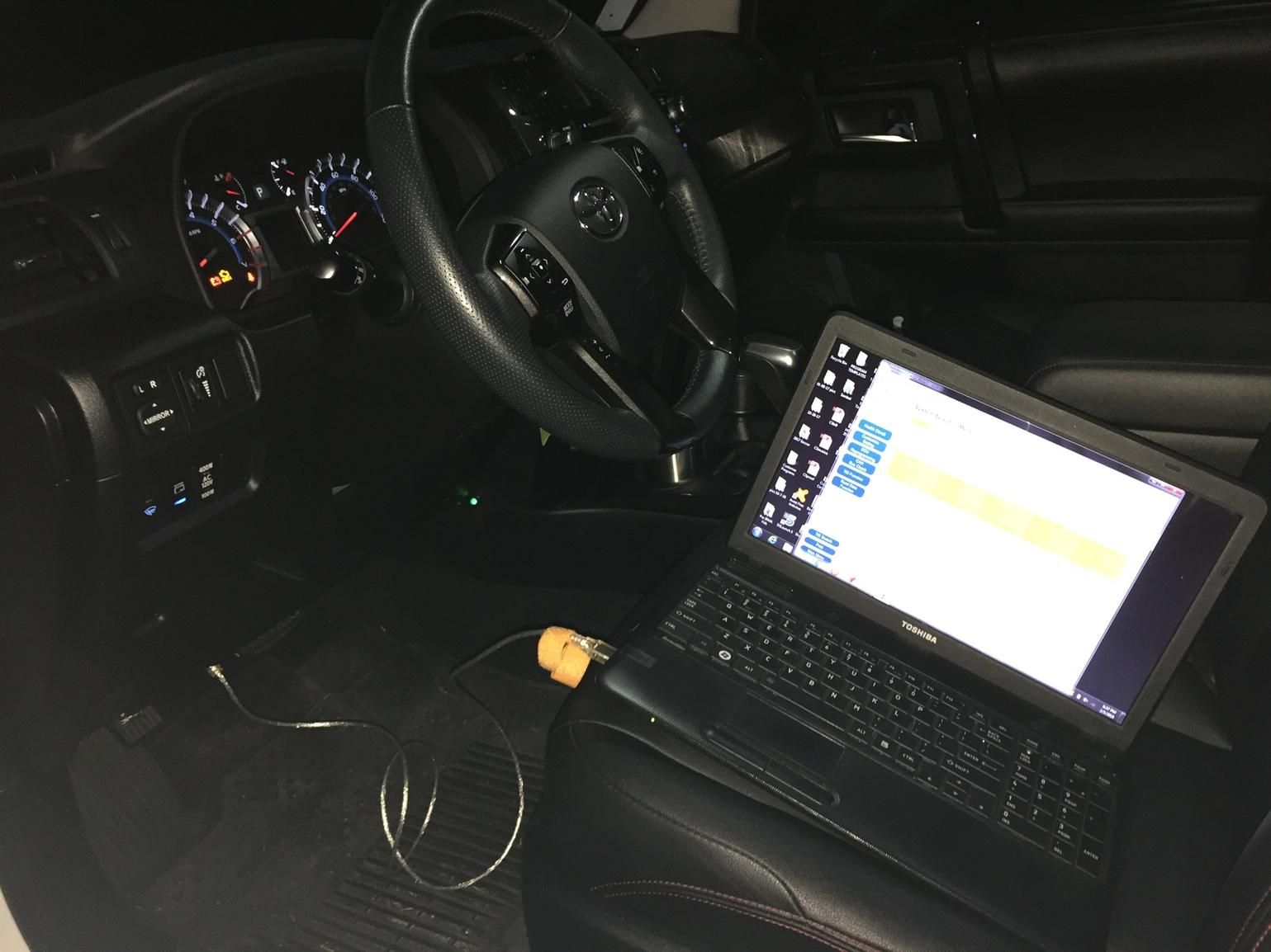

For those looking to change settings and not do any real time monitoring tech stream is worth considering. I was on the fence between it and cariata and decided the extra Toyota functionality may be worth it down the road. So I bought a cable and the v12 software off eBay for $35 and figured if it didn’t work out my kids could still go to college. Well. I got the package yesterday and set up was pretty easy. Granted I am familiar with windows but nothing I had to do was rocket science. I watched the included video, read both read me files and then followed the directions. 15 minutes after opening the package I was in the car changing settings. Banished the eco bar and seat belt chime, said good bye to the auto lock and unlock from park, added window up and down features for the key and fob, changed some wiper intervals and then called it a day. All in was 20 min from start to finish. Much happier with the car now and the time/money saved not going to the dealer. Only regret is waiting a year into ownership to do it. If anyone is in Sacramento and wants to make some changes, pm me. Happy to meet up when schedules allow and do it for free.

here is the one I purchased:
https://www.ebay.com/itm/Mini-VCI-D...e=STRK:MEBIDX:IT&_trksid=p2060353.m2749.l2649
I am running it on an older laptop with Win 7 64. It says it will work with Win 10 too.
Think I found the same thing on Amazon for a few bucks less.
https://www.amazon.com/J2534-V12-10...26&sr=8-3-fkmr0&keywords=Techstream+V12.30.17
And here's another for $15 cheaper.
https://www.amazon.com/Fangfei-Mini...26&sr=8-2-fkmr0&keywords=Techstream+V12.30.17

I have a '13 LTD and am purchasing the both a BT ODBII (and try the trial of Carista) and the cable + Techstream. I'll return whichever I find less helpful. I do have a laptop that can run Techstream w/o issue. I want the smart key functionality for the windows as well as the changing the other things that many have mentioned.

FYI - saw this in the amazon description:
Attention: we have tested this product compatible windows XP and windows 7 32bit, it not support windows 10 or 8.
so make sure you know your OS before ordering. I can confirm the software package I installed runs fine on 64 bit Win 7.
