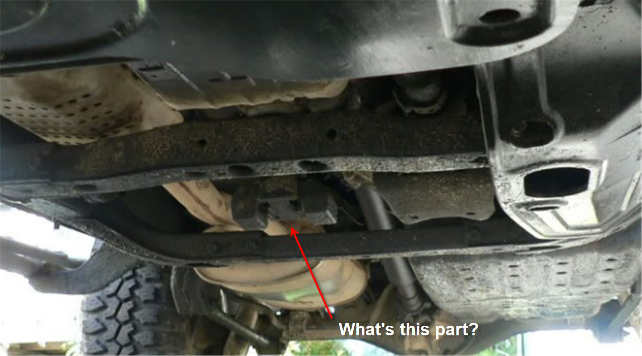

Does anyone know what the weighted part is? Mine is broken and I have weird vibration noises.
Thanks.
What it's called escapes me currently but it's exactly what you described, a vibration dampener. Often times automakers place these rubber blocks along the underside of the car to help absorb the vibration and noise generated from both the road and the vehicle itself

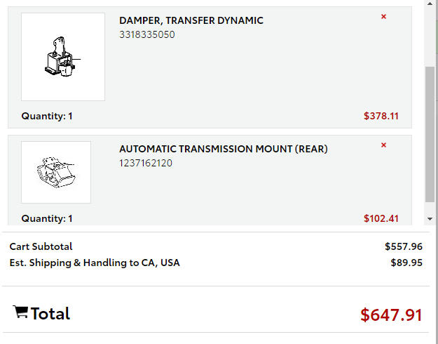

It's called a DAMPER, TRANSFER DYNAMIC #33183-35050. It's a $350 part so i'd recommend getting one from a junkyard if you can.
Thanks so much!
Toyota $500 Yikes --

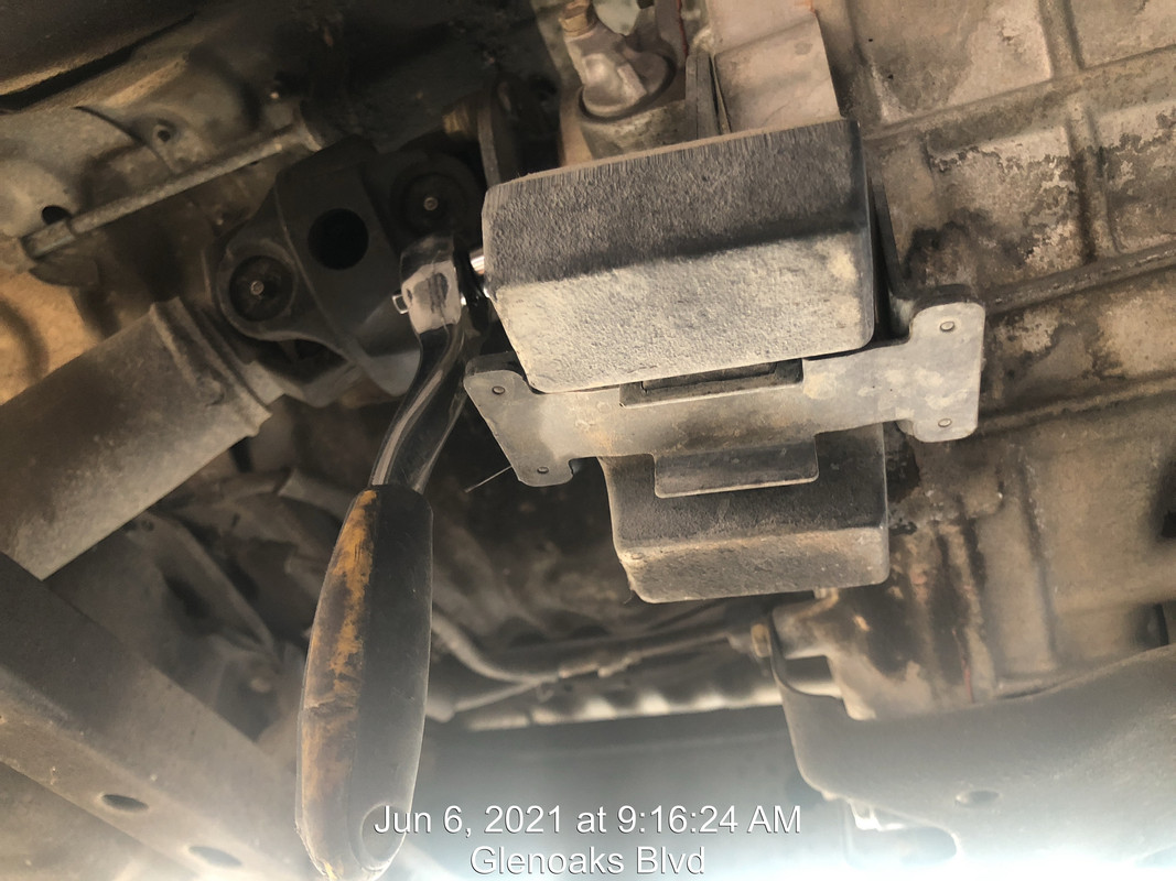

Found it at Pick Your Part Sun Valley -- $21.50. Luckily a 4Runner was in the Chrysler section untouched -- talk about lucky!!!
Thanks, everyone for your help.
