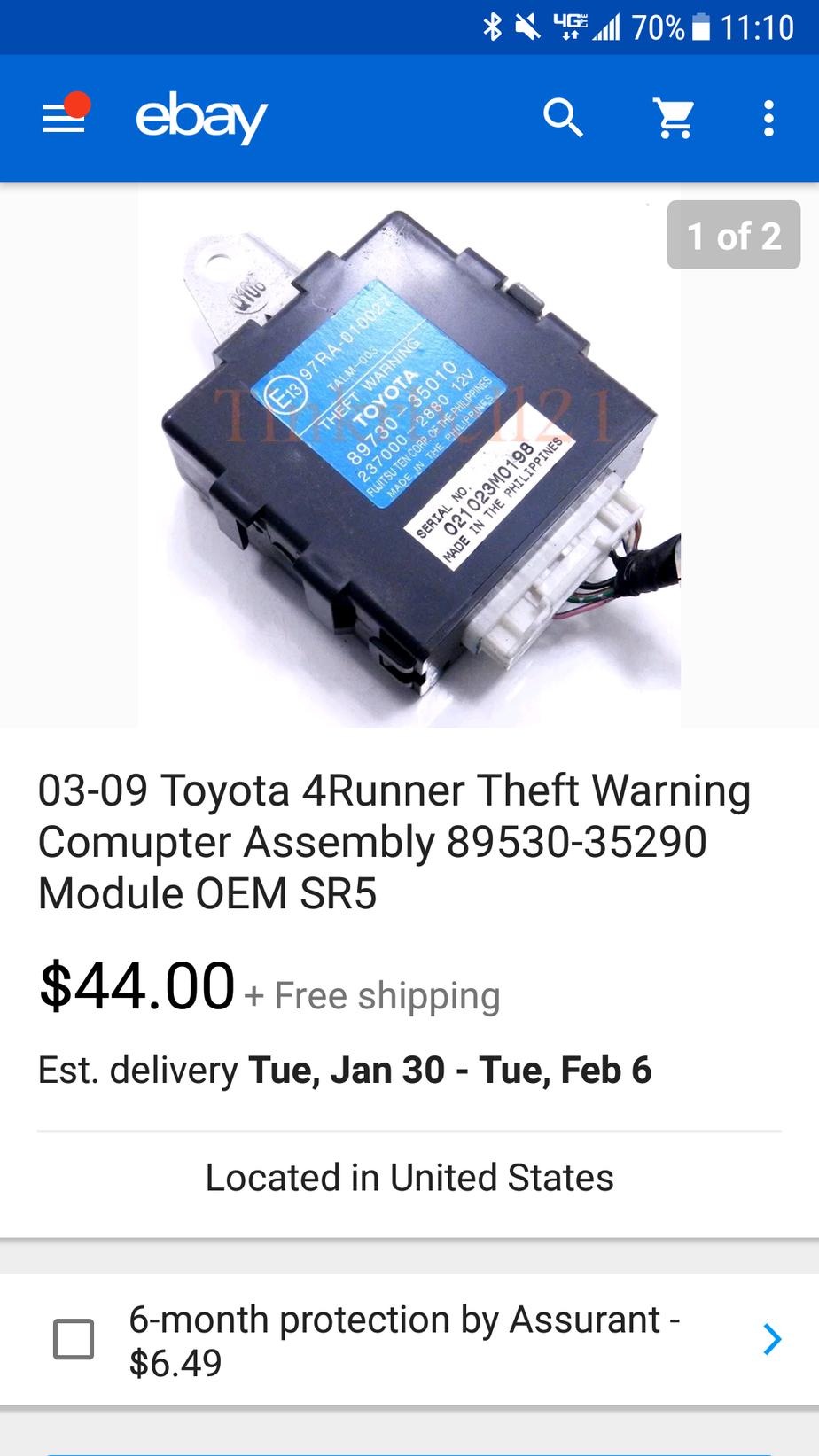

You can add OEM part 89730-35010 and add the alarm, its plug-n-play.

So you're saying i can just add this part to get the factory Alarm? That simple?

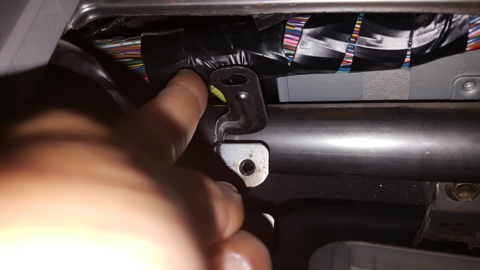

The plug is behind the glove box, upper part and is tied to a bar. I will try to get a picture in the next couple of days.

Perfect thanks !! Also found the diagram where it shows all 3 components shouldn't be to bad . Need a screw or to secure it ?
Many thanks to [MENTION=86859]djkurious[/MENTION] helped walk my ol'ass thru the process of finding the plug , which mine was taped up on that stalk of wire & awkward to get too ! But I have skinny hands & pulled em down . Checked for steady light & all was swell ! :bigok:

Thanks to k3v11n and djkurious for their information about the part needed and where to place it in order to have a working alarm. Except for the alarm not activating when the hood is opened, it works for the doors which is good.
