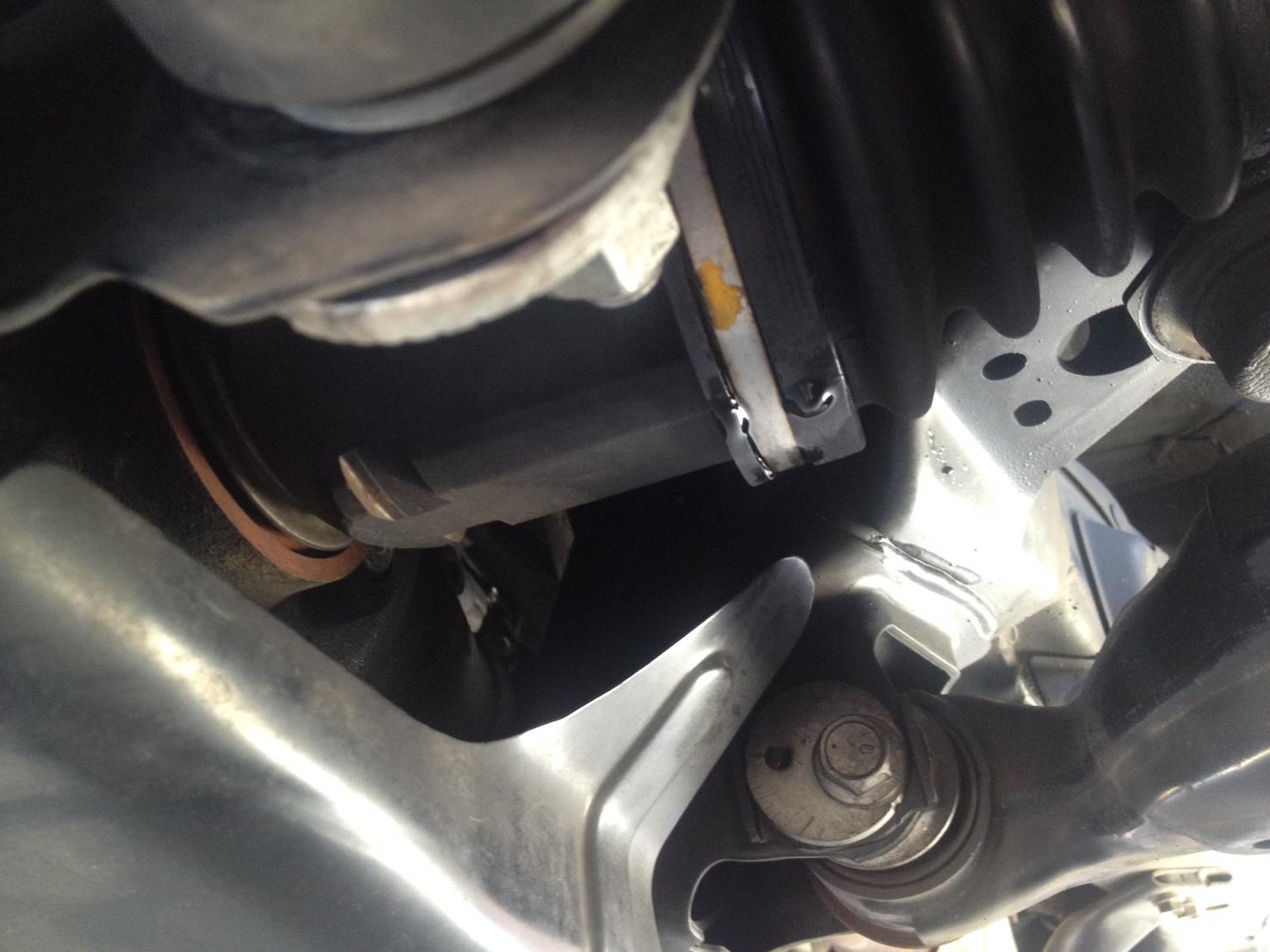

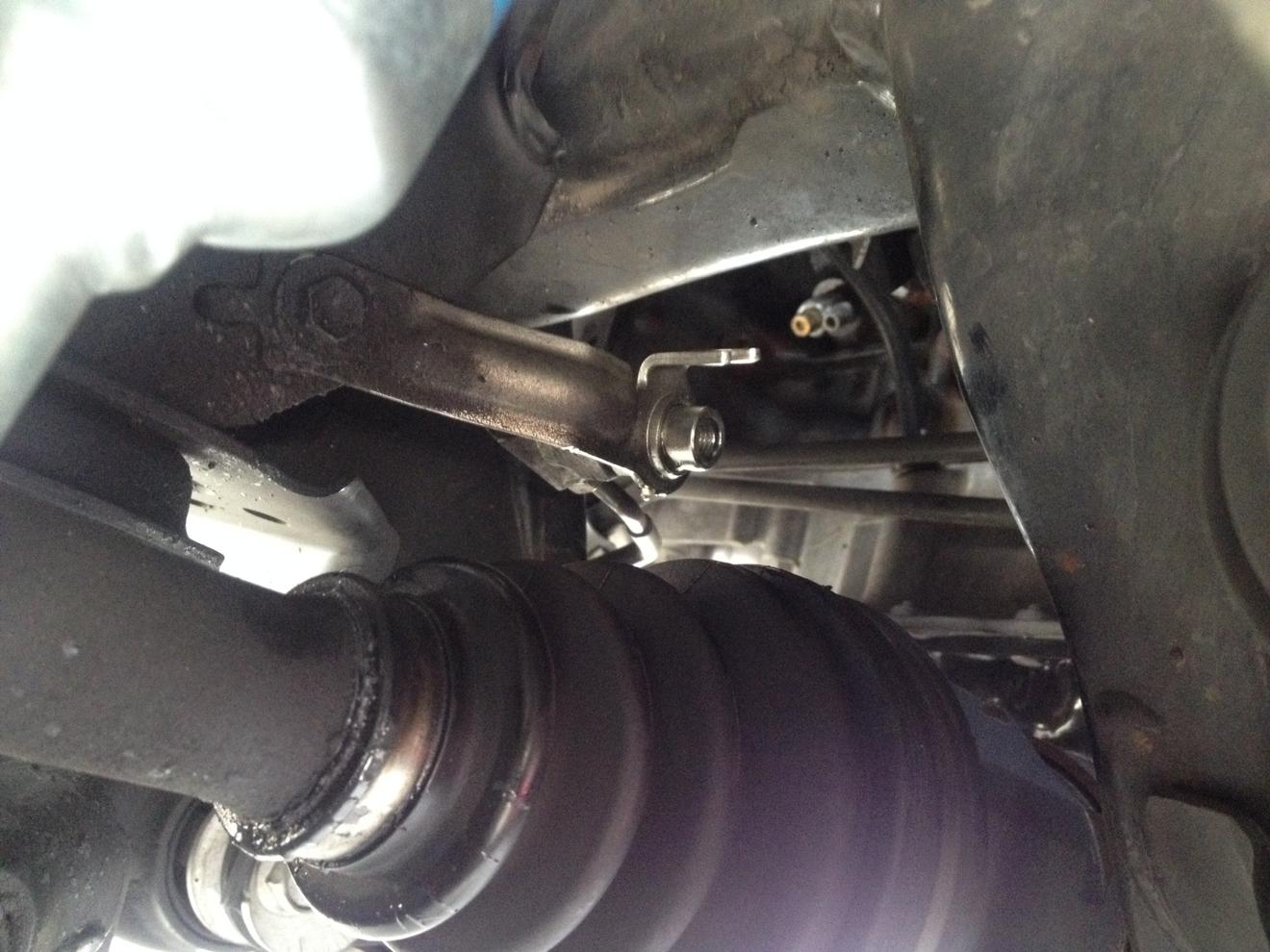

Ok I had another thread awhile back but here is the short summary. Removed the blown out XReas and had FJ Spring installed in the rear and all new adjustable Bilestien shocks installed on all 4 corners to level the truck out. I didn't get any kind of CV Boot leaking when I did the suspension work, only started after I upgraded my tires from 265-65-17 to 265-70-17. The day I put the new tires on I had some dripping from the bigger clamp on the boot, and it had since stopped. However today (a few weeks later) after a short drive I backed into a driveway that has a lean to it and noticed its leaking a bit more again. Below is a picture of the drivers side, and now I noticed the small gap by the axle seal. Does that look right, and if not could it be the axle that is leaking? Differential? There is no fluid by the gap, just coming from the big clamp on both sides of the truck. The passenger side has no gab by the axle seal at all so figured I would reach out to you guys. The fluid that is leaking is very watery, and doesn't have a really bad odor to it. I mention that because someone had stated that axle grease smells really bad. Someone else mentioned this could just be the grease bleeding a bit because of the different angles from the front getting leveled out combined with the warmer temps here is AZ. It went a few weeks without any more dripping but I am backed into a steeper driveway. And ideas?

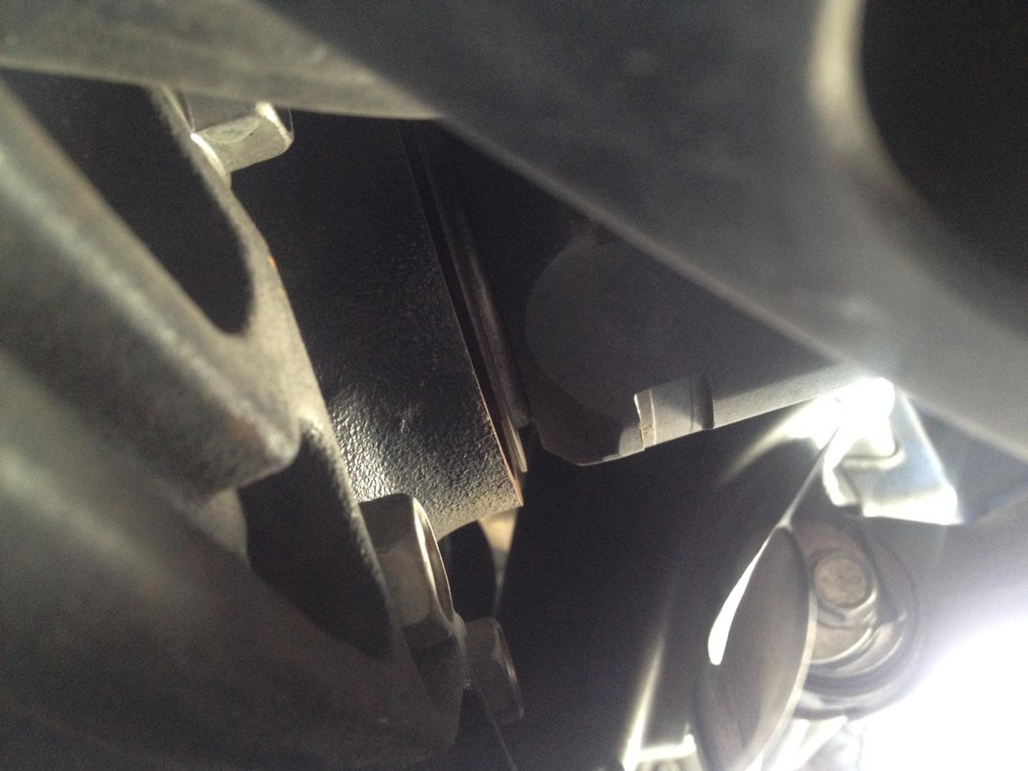

OK thanks to my brother for getting under and taking a look, we confirmed the leak is coming from the fitting above the boot shown below. Can anyone here confirm that is what is left of the XReas? I believe so but would like to confirm so I can not worry anymore. Thanks in advance..

Looks like something is dripping on to the CV axle...doesn't look like it's leaking from the CV, though. I would clean the area and check back tomorrow. Not the axle seal on diff...just replaced one myself & it would be coming out where axle mates with diff.
I confirmed its from that fitting about the boot on my second response, just wanted to verify if that is indeed whats left of the XReas system....
Just looked at pics again...sorry for confusion... You're saying those open fittings (one of them?) is dripping something? Did they remove your brake lines?? I'd have to check under mine to see where those lead.
Not sure what you mean by "Xreas system". The Xreas are the shocks. That is your CV axle.
The XReas shocks are linked together with an hydralic type system. That fitting about the boot is the source of the leak on both sides. The fluid is leaking out of that fitting and dripping down the back of the boot and then coming off the bottom of the boot. So at first it appeared that it was the boot leaking but we have since confirmed where the fluid is coming from. I am 95% certain that is what is left of the Xreas system but waiting for someone here who knows for sure to confirm. So yes you are partially correct, yes Xreas are shocks but there is more to it then just shocks...
