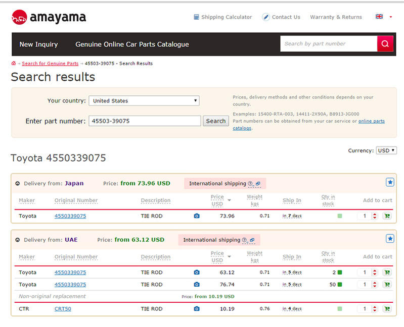

Amayama Trading
OEM Inner Tie Rod - 45503-39075
