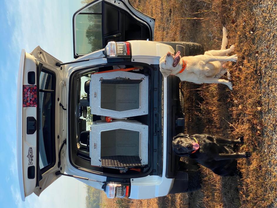

Good choice with the ruffland, very nice kennels. We have two large which sometimes have ratchet straps (the orange things) just off the two side attachment points. Not the same application as yours but maybe helpful?
Don't know what the pic is sideways...I didn't take it that way

Here's the set up I use for my two Labs. TransK9 box, I strap it to the second row headrests, but realistically it stays put without it.
