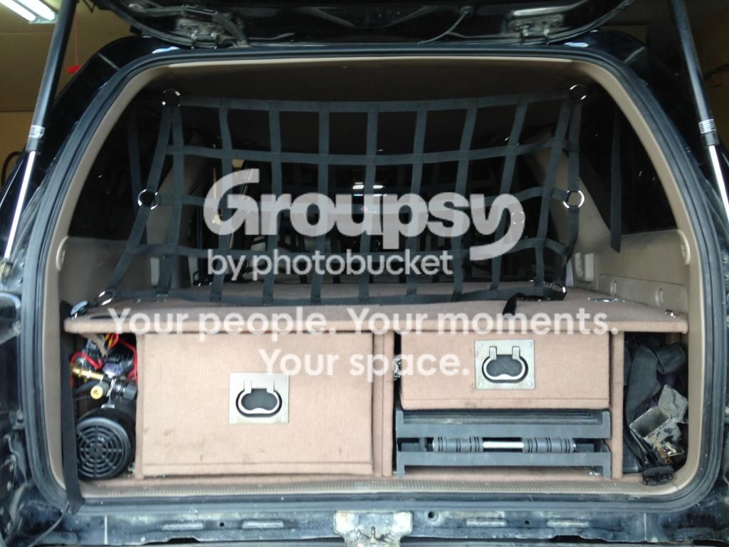

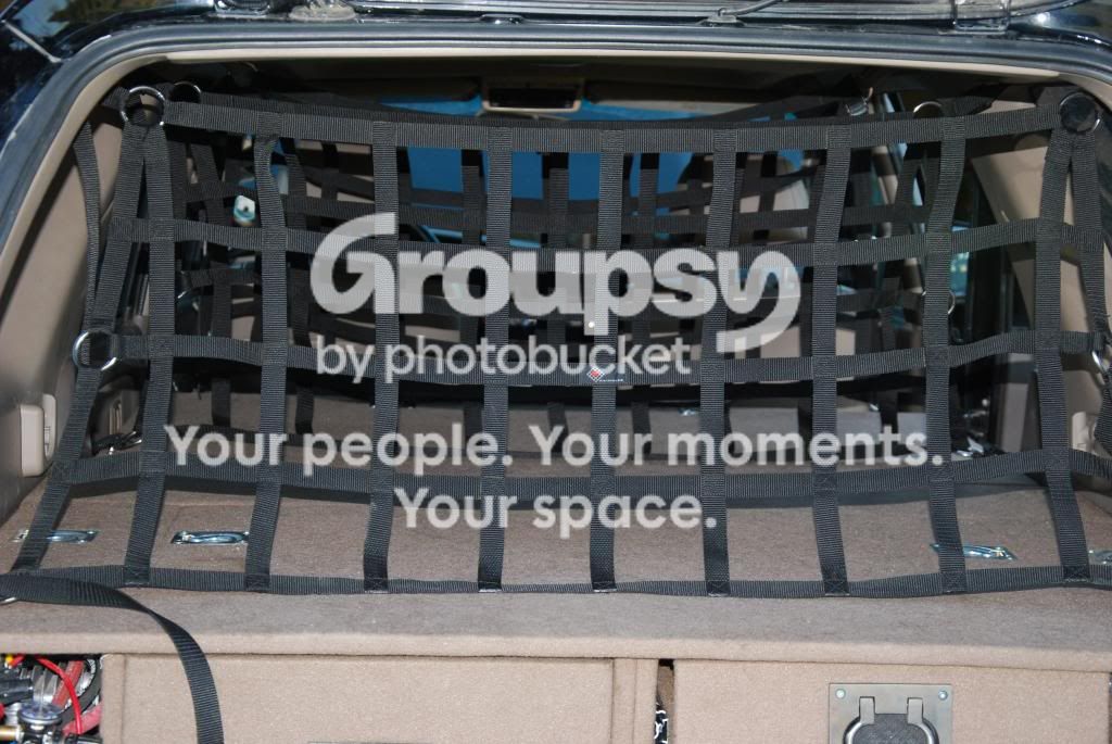

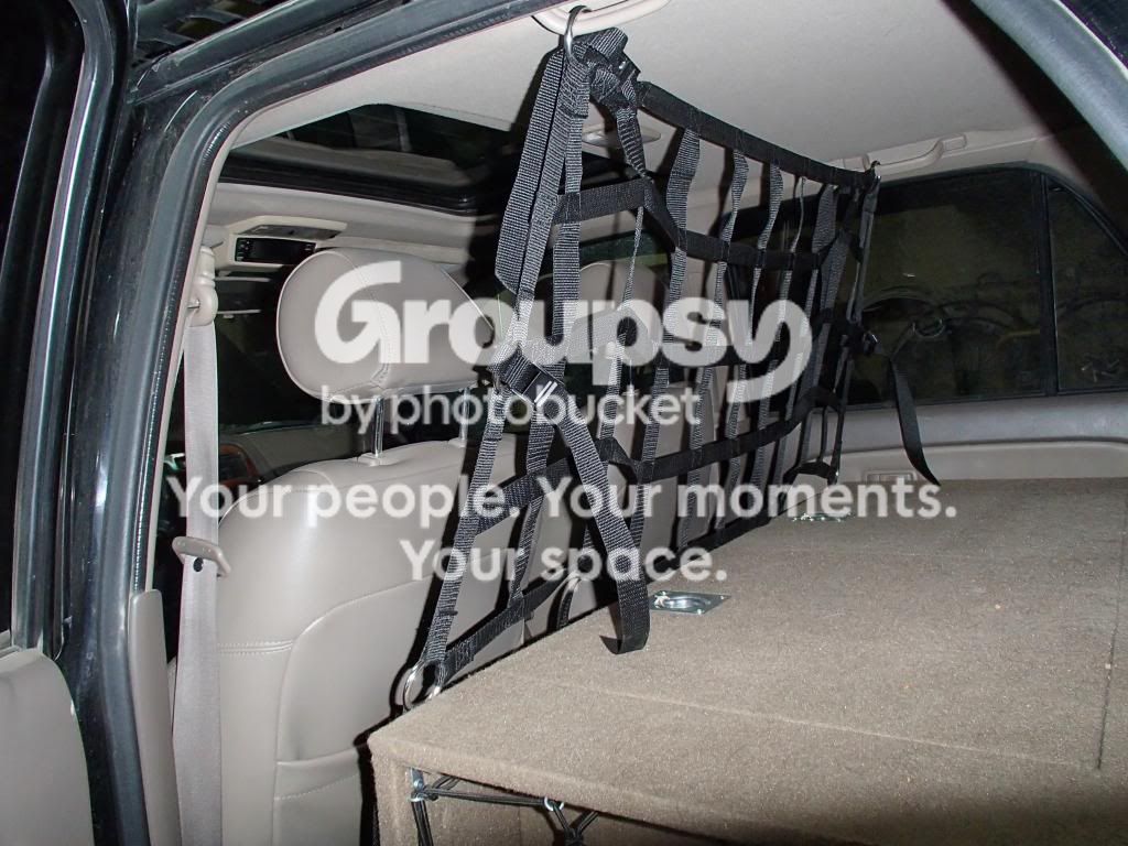

Check out Raingler nets - I purchased 3 for the interior of my 4Runner. I do believe that this is the 3rd Gen 1/2 Cargo Net option. Works great so far. I added a whole bunch of footman's loops to anchor it all down to my platform - even more have been added since this picture was taken.

3300km round trip and the nets worked fantastic - cargo basket secured by a large 8x4 net (I believe those are the dimensions...) and the cargo stayed in place between people and the dogs.
Not to mention the rear window was down a large portion of the trip giving our pups fresh air to sniff. They stayed put and had a large portion of the back all to themselves.
Happy with the product and the function of my set up. Minor adjustments were initially needed but that's the ebb and flow of every project.

Really a nice install. How did you affix the netting to the top rear corners?
ETA: I went to the site and saw what they have there. Pretty nice setup. Was that a good, solid system, shouldbeasy? Is that all you needed to use?

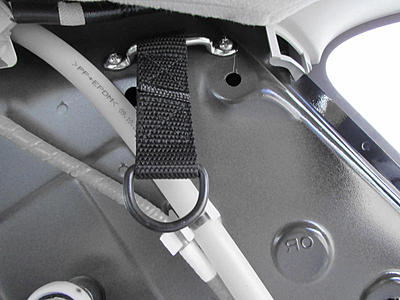

Here is one of the pictures:
261533_379dab3e5da443ccb677a221483e31f2.jpg_srb_p_400_400_75_22_0.50_1.20_0.00_jpg_srb

My version was to use the straps attached to the net already (it had those pull straps on the 4 corners) combined with the footman's loops anchored by #8 and #10 self taping metal screws.
For the back I had to take the rear plastic panels out, pick out the location at the top of the vehicle that could take the self tapers and then cut away some of the plastic. It's worked very well and doesn't even show much.
The top mounts for the nets (specifically the human and cargo nets) is anchored by footman's loops over top the headliner and in to the roof support. Location wise I lucked out as these ridges for roof support were very much in line with the nets I had already installed. As my equipment securing adapted to the different / heavier items I was loading I added more and more footman's loops for additional security.
I'll throw up some pictures soon of my 'complete' set up with all of the mounting spots.

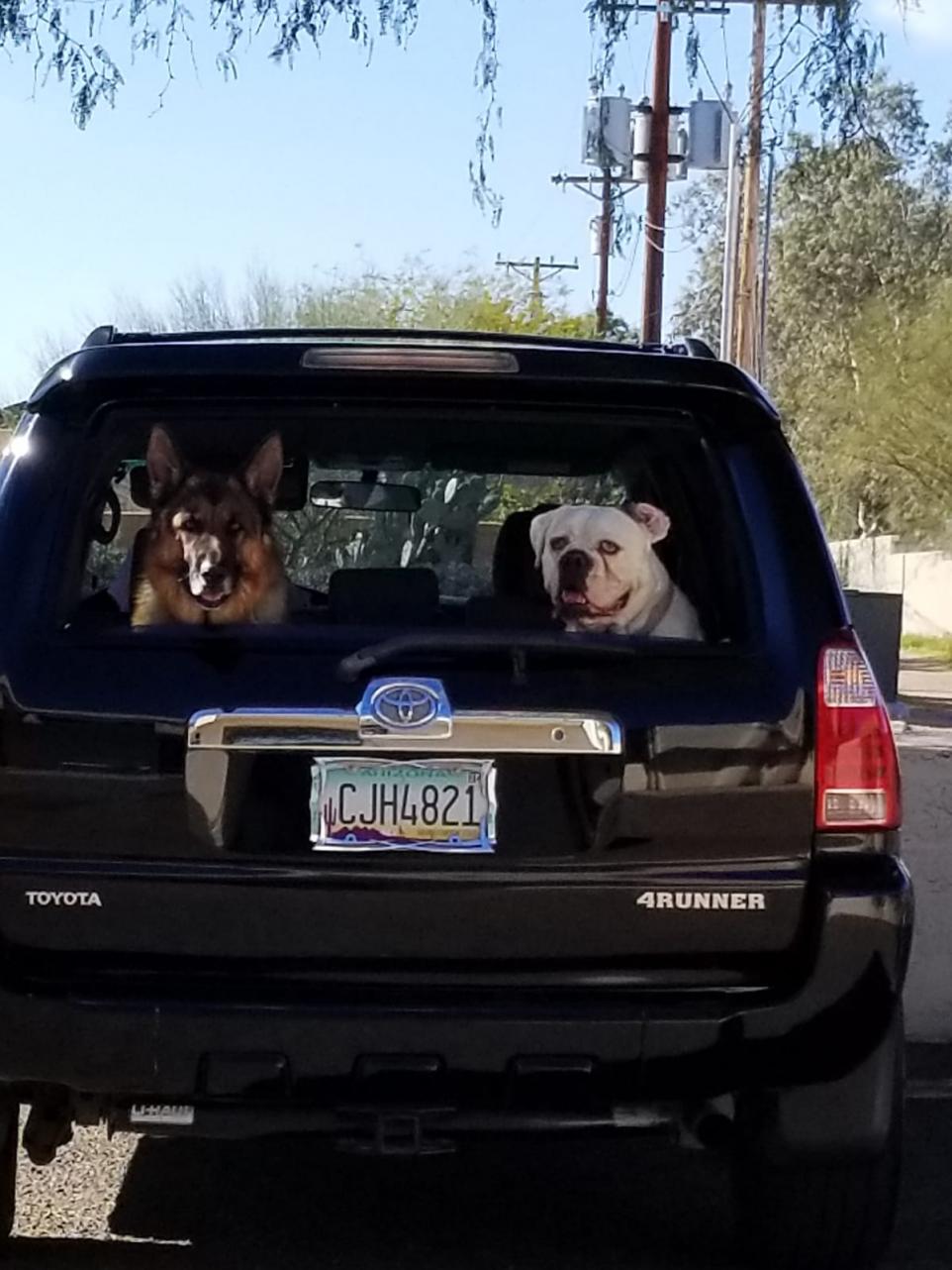

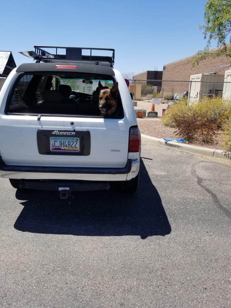

Here is 1 of the GS. The AB was to lazy to come that time. Here is 1 of them in 4th gen during their trip to the vet. They are not always perfect (the ab will clear the room or car with a fart) but they r good dogs
