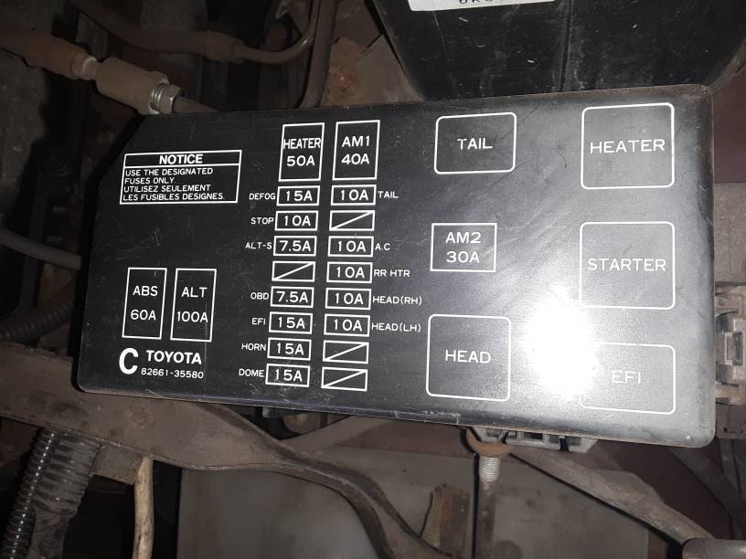

It is the dome fuse in the engine bay. Replace and everything should work again. That fuse does alot. The radio dome lights and also all the door switches.
Damn, under the hood?? Most cars have them under the dash.
Well i know thats where mine is. There are 2 fuse blocks in our trucks in the truck under drivers side and one in engine bay. The dome fuse should be in the engine bay atleast thats where mine is. I had this same problem awhile back.
There are two location in our trucks for fuses. One box is near the battery under the hood and the other is in our truck located to the lower left of our steering wheel.
It would be the DOME fuse or ACCESSORY. Something of the sort. I am not near my truck right now.
When I pull the Dome fuse, I loose power to the radio and Dome light. If you are 100% sure the fuse is good and both your radio and dome have no power. I would do a continuity check on all wires in that circuit. A factory service manual electrical diagram will show you what's all connected to that circuit and what the color the wires are. :) 20190831_133332.jpg
