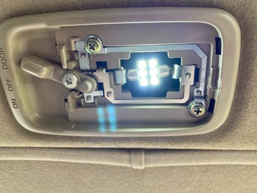

So I actually tested the socket it self without the led in place, that’s when I got two volts. I might be doing it wrong as far as testing cause I just had my red lead on one side and black on the other with my meter on volts
You need to put your black lead on a bolt head or screw head that is screwed into the body or frame.
With the black lead on a metal screw head one side will read voltage and the other side will not.

when you switch the dome light switch onto the ON position (e.g., it would normally produce light if your circuit were working, regardless of door open or not) do you get the 0.8v reading across the terminals of the dome light, in addition to using the positive of that to body ground? if so, then that says proceed to next step. if it's actually 12v, well then problem solved there.

with that unplugged, and after you checked the connections to the radio, it's worth another try with the dome light prongs to check their voltage with the dome light switch set to ON. you ought to get +12 in general, and obviously something's giving you an open circuit, or one with a lot of resistance.
another test to be doing is to make very certain that the fuse for interior lights is good. visual inspection technically is enough most of the time, but set your new DVM to its continuity setting and touch each DVM lead to one prong on the fuse, held in your hand (polarity doesn't matter). it should beep or light or whatever your DVM is made to do with continuity. it's good practice to always briefly touch the DVM leads together in the continuity setting first (just by themselves) so you both know what it will do (e.g. light up) or sound like (beep), plus that you know it will test continuity at all. once you are certain that fuse is good (e.g. you got a beep), then put it back into the fuse panel and see if your dome light works.
On my dome light (97) the switch side is the 12v side and I read full battery voltage. I used the right hand Phillips screw as my ground.
My LED light is polarity sensitive. It only lights installed one way. If you rotate it 180 degrees it will not turn on.
The right hand side of the bulb socket is the ground side. Reading ohms on your meter you should see low resistance to the screw head just below it with any door open. Kilo ohms or less. I read anywhere from 40k to 9k with the door open. Pushing in the switch makes it go infinity.
