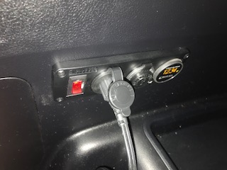

I ran a line to the back, have a panel back there now, best thing I ever did
