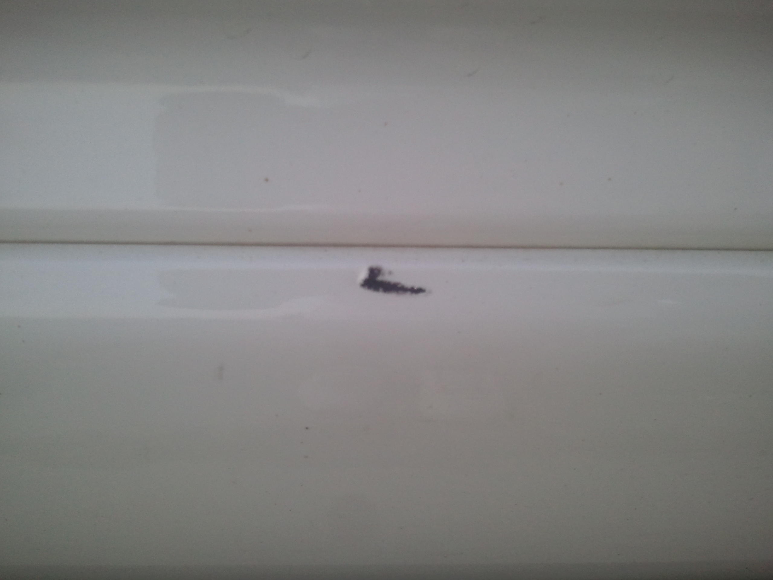

So my girl and I are at an amusement park in Denver, this idiot is in such a rush to get out of the car she gouges my front passenger door with her door.
Luckily we were there; I imagine this would have been a ding and run scenario if we were not.
Anyway, what to expect from her insurance. How do I not get robbed for the damages.
The scuff is down WAY past the paint on the trim.

Have them give you $100 and then just put some touch up paint on that, but the way paint repairs go, they have to respray the entire panel... That will be atleast $200+ for a decent job.

Right, more than likely they'll need to repaint the whole door. I was thinking the estimate would be closer to $500.
Did you have an insurance company out to look at it yet?
You dont want to repaint one door panel with metalic paint, it will look worse than a ding with touch up on it. Get an estimate, get the money, touch it up like stated above.

white is one of the hardest colors to match too. So I would touch up paint and get an estimate at a shop and take them for the full load. teach them sob's a lesson.

Are you talking about that little scratch over plastic clading or is there a ding that I cant see on pics?
terrible pic, but if its just that scratch, i wouldnt file a claim for it, just touch it up.

I think most of the responses so far would support the above advice. I don't mean to trivialize the damage to you car. But like others have stated, its just a door ding (actually not a ding but from the looks of it, a paint gouge). It sucks that it happened to your car but it is the price you pay for operating a car in a society full of idiots. Don't get me wrong, I'd be mad too.
If you really want to pursue it via the insurance route then do this. Go to 3 high end body shops in your area for estimates. Paint on plastic surfaces are extremely difficult to match with metal surfaces so they have to repaint both the door and the plastic cladding that was scratched. Then they'll have to blend the paint onto the body panels on either side of that door. If they don't, you'll see an obvious difference in tint, surface texture and gloss. Present the estimates to her insurance adjuster and tell them you will settle the case for the average of the 3 estimates. If they decline then tell them you will take it to the highest shop and go through your insurance company.
So once they settle the case with you and cut you a check (which will probably be around $500). Go your local Toyota dealership and buy a can of Natural White (056) Touch-Up Paint P/N002580005621 for about $8. Touch up the scratch and keep the paint for future scratches. Then take the rest of the cash and take your wife out for a weekend get-a-way. :cheers:
Seriously though, you probably want to avoid the insurance/body shop route. The end result may not be to your satisfaction. I have never had any body/paint work done where I was satisfied same as factory. You'll be out a car for a week. You'll have repainted panels and a carfax hit on your car's record which may affect resale value.
The "$100 and touch-up yourself" is really a sound piece of advice.:thumb3:
If it's in the cladding and you're having the body shop fix it, I would try and push them to replace the entire piece. They're pre-painted from Toyota.

Good advice, I will go and get estimates, I wont attempt to get it matched after repair. That's going to be near impossible. Already have the Natural White (056) so I will make it work after the fact.
Better pic?
