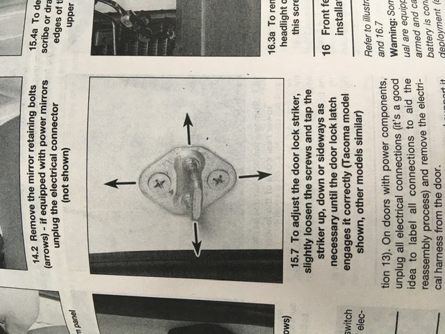

From the Haynes manual. Not a good book but all I have.
I suppose you could only do fine adjustments with this.
This is a load of crap to me, the screws immediately realign the latch to where it was originally. Which makes sense, given theres isn't an open slot for them to move around, but a specific hole which doesn't allow for wiggle room.
It’s the nuts that move. They are not directly welded to the body. They are welded to a plate in there that is semi floating. A hammer tap can slightly move where the nuts are sitting in the door frame. Of course the range of motion is small hence the fine adjustment comment.
