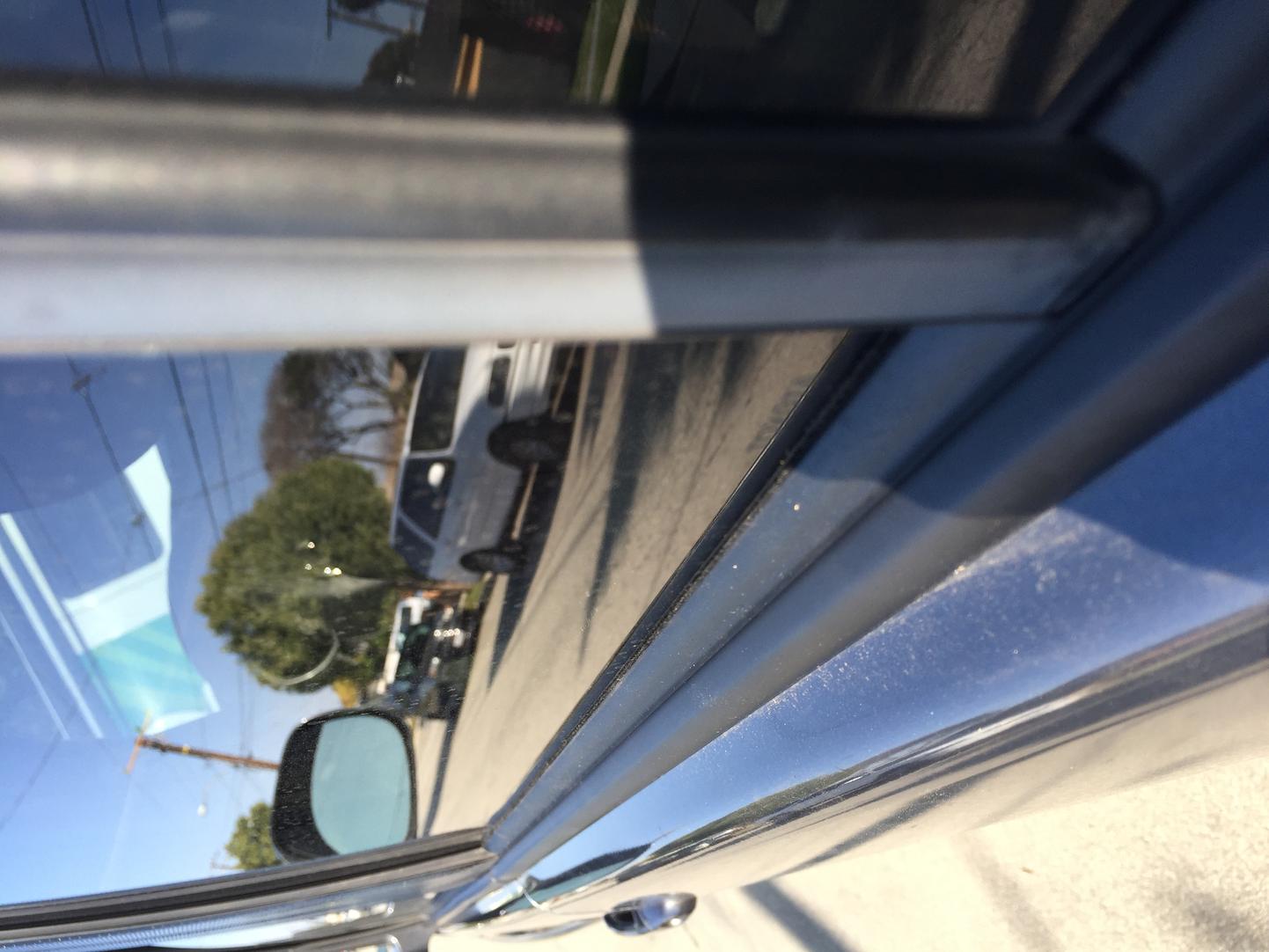

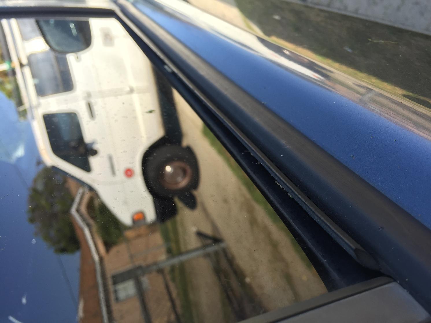

Little by little I've noticed my window weatherstrip tear more each day and finally went to the parts dealer and order them. I just replaced all 4 and man what a difference the black is so rich and the fitment of the trim against the window is new again.

Having the same issue. Only on the driver side. Do you happen to have part #s? Also, how complicated was the replacement? Thanks!
I believe this was the drivers door
68161-35060
Passenger front
68162-35060
Here are the rear doors but don't know which was right or left
68163-35030
68164-35030
05 T4R SR5 V6
Thanks for providing the correct part numbers. Ordered, received and replaced.
