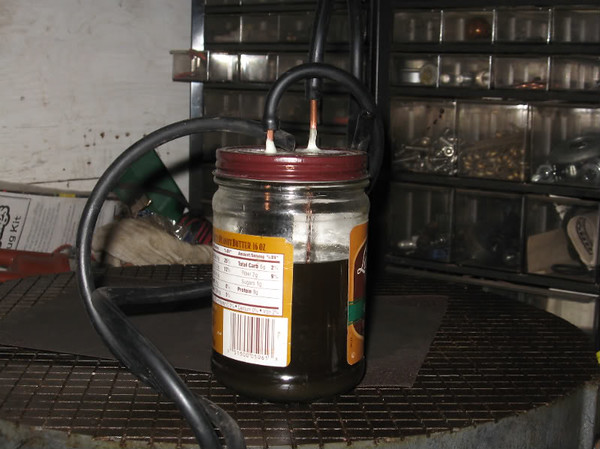

When you get tired of the tiny capacity of the mighty-vac reservoir save your next empty peanut-butter jar and buy some J-B Weld putty and some 1/8" copper tube.

Great idea, would never have thought of using engine vacuum to bleed the brake system!
