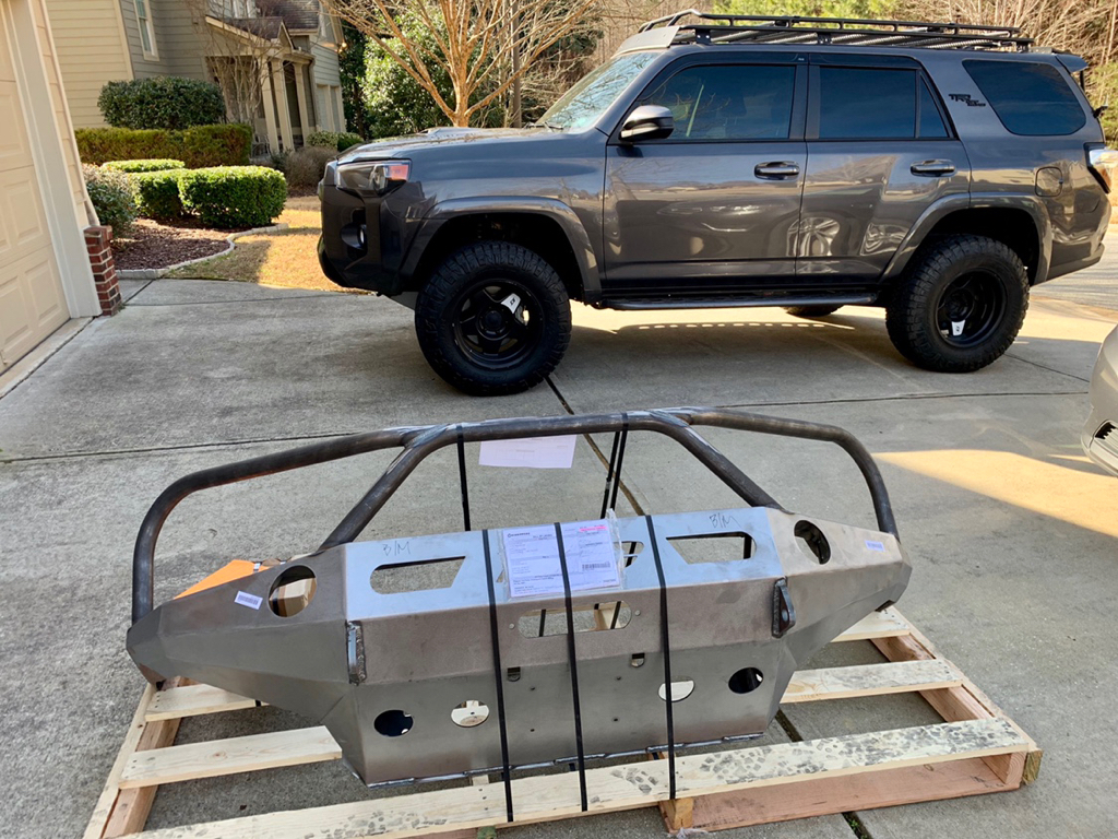

It’s going to be a great weekend. New front bumper just showed up. I’m starting the build on the rear bumper tomorrow. I also was able to order a 5th F5 from SCS in black this week. Ended up staying with F5s. The Ray10s look great but I’m going to hold off.

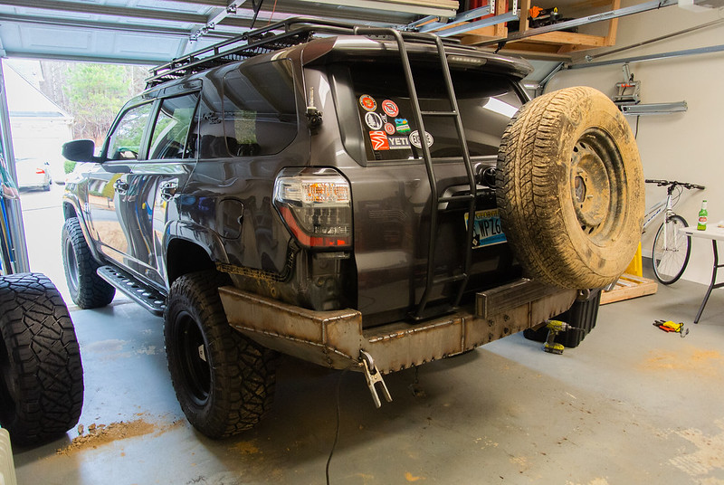

Started the Coastal Off Road rear bumper build. Made some great progress. Still a lot of welding, grinding, and painting to do.

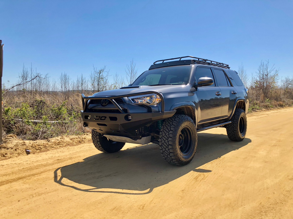

I'm enjoying this build process again and looking forward to perfecting this rear bumper and moving to the front, again.

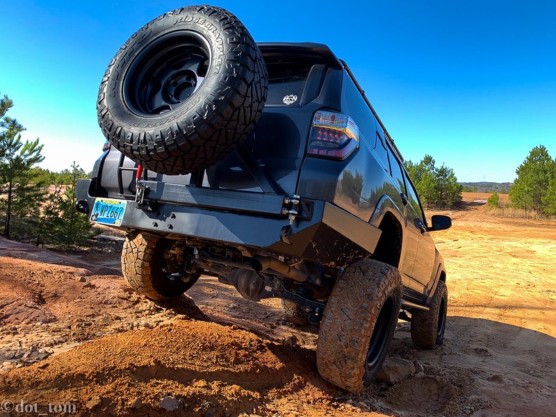

Couple photos of the completed bumper. Still need to work on the OEM bumper trim a bit. I'll have it finished up this weekend. Also going to cut down the rear tire mount about 3.5" to tuck in the lower offset F5. Sticks out a bit far due to the offset and width. Going to mount the high lift jack also. Just need to decide where exactly I am going weld the brackets. Couple ideas.

Looks good. Where are those pics taken? I need somewhere close to go besides the Springer Mountain forest service roads.
