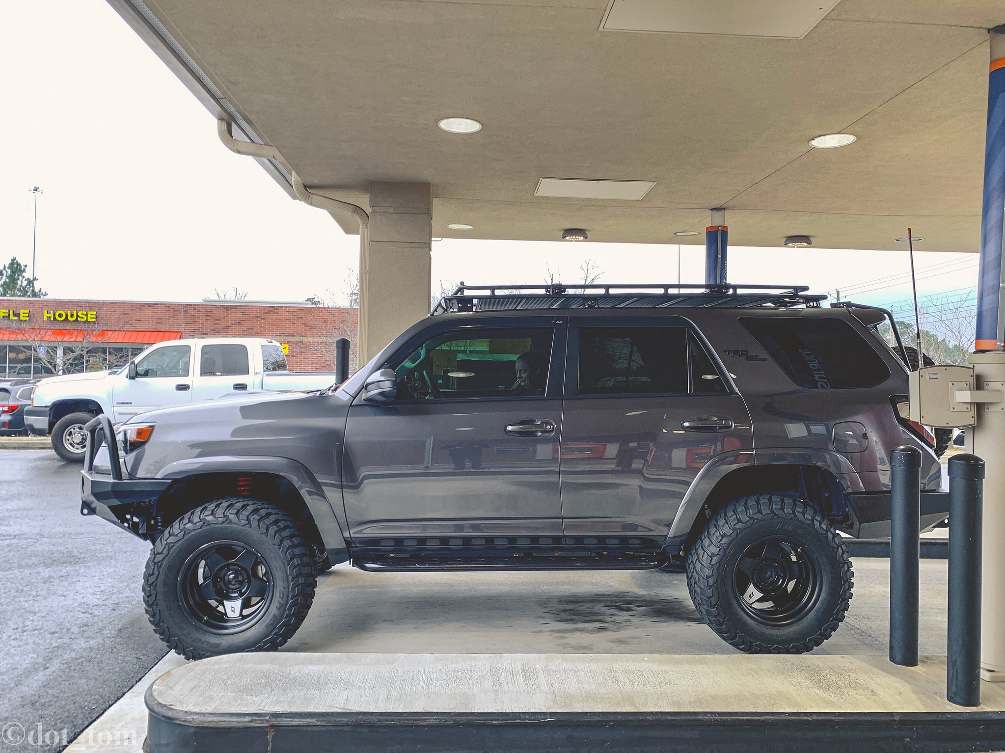

They are noticeably louder compared to the Nitto RG R/T. For a brand new MT they aren't bad. Definitely on the quieter side. It's a progressive scale from AT, RT, MT. It'll take some time to feel them out in different conditions but I'll be in some mud this weekend and plenty of rain.

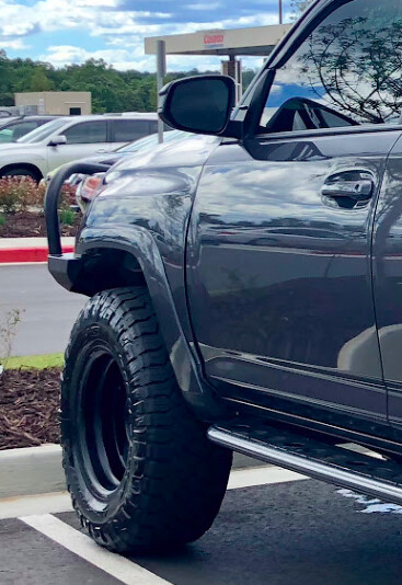

Also, something else to consider. The BFG KM3 is not much bigger than the 285 Nitto RG. This is my only real big complaint. If these came in a 305, I'd say that would be closer to the true size of a 295 RG. These aren't as big as my old 295 Nitto RG's that's for sure. Nitto RGs in 295 were 3 mph off on the speedo. These are almost dead on, just like my 285 Nitto RG's. I also had to space out my fenders and make more room for the Nitto RG's in 295. These fit just fine without my spacing I did on the OEM fender.
In this picture you can kind of see the gap between the fender and driver door. I used a longer bolt and a couple of washers to push out the bottom of the fender to create additional clearance for the bigger 295 RG tires.

To compare to my setup. Ground to fender in my garage is 38” front and 39” rear with these 295s.

could you post pictures of how to do this fender spacing you explained you did for the 295s?

I can this weekend. I’ll take some detailed photos for what needs to be trimmed and spaced out. I think it would help the community greatly. Everyone will be running 17x9 -38 and 295s once they see how easy it is :D

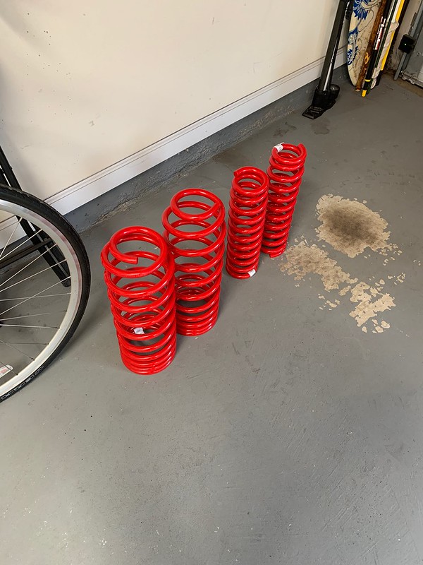

I picked some new coils to handle the extra weight. Dobinsons 314 up front and 675V in the rear. Long travel rear shocks are on back order but plan to get those soon also. The 675V is rated for stock weight for 3". With the rear bumper I netter a solid 2.5" or slightly more. Rides great as well.

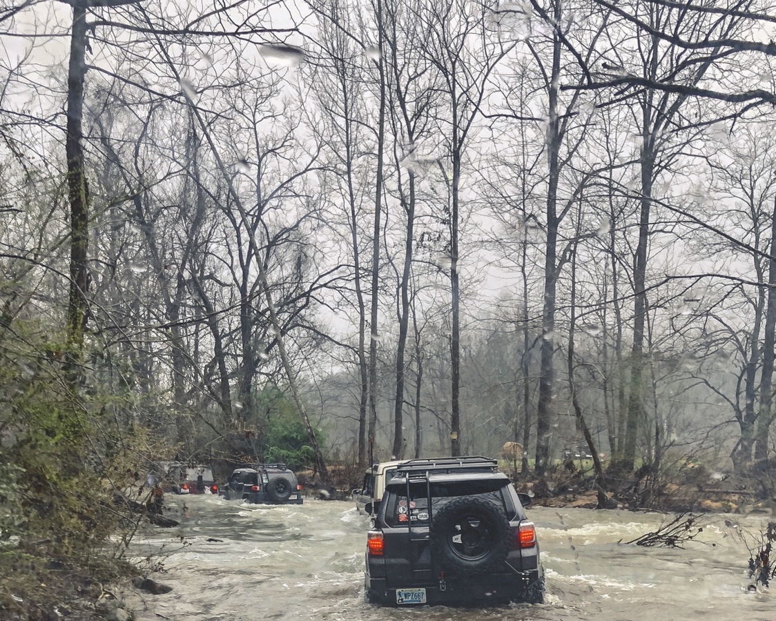

Hit some trails in Chattanooga this past weekend. Weather was not ideal. Lots of rain and due to a jeeps broken steering box we had to turn around and back track through 3 river crossings during a monsoon. We were prepared to camp out for the night if we had to. We ended up making it out safe. Water was up to the headlights on the way out. Of course, I didn't have my snorkel, haha but the air filter came out clean. Glad I had the ARB dif breather setup.

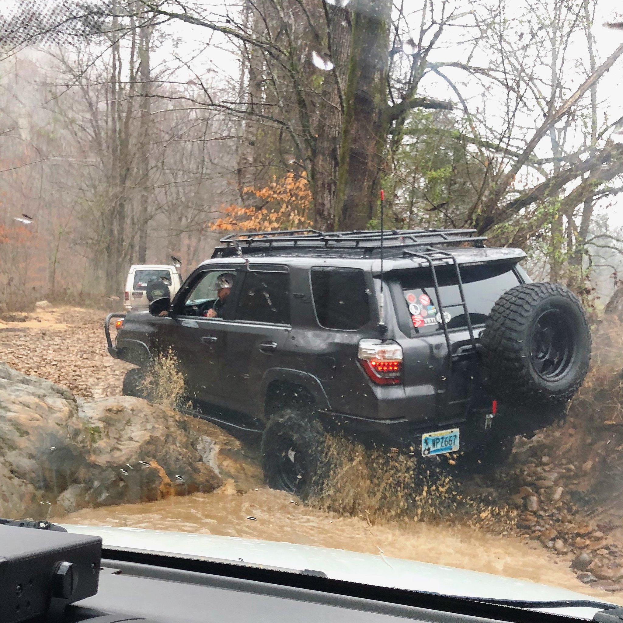

This rock and tree were a tight fit. I was turtle'ed for a minute but got through.

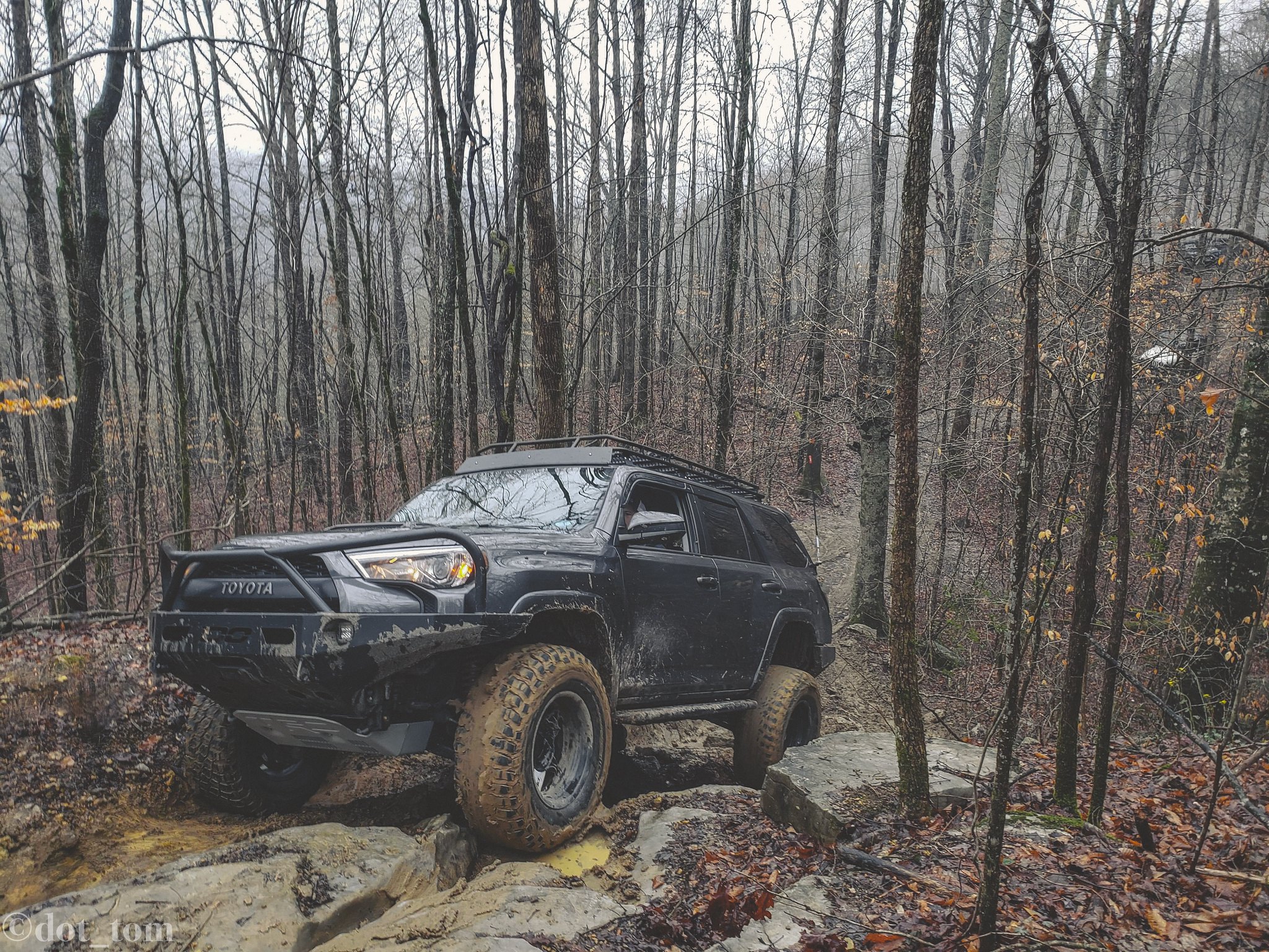

I had the KM3's in a lot of mud last weekend. I was very impressed with them. Much better than the RG's and KO2's obviously since it's a MT. I am very happy wtih these tires. Just wish they made the KM3 in a 305 since BFG tires run small.
