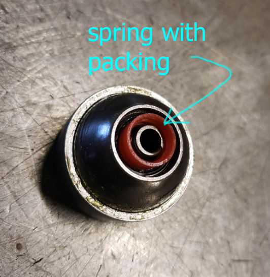

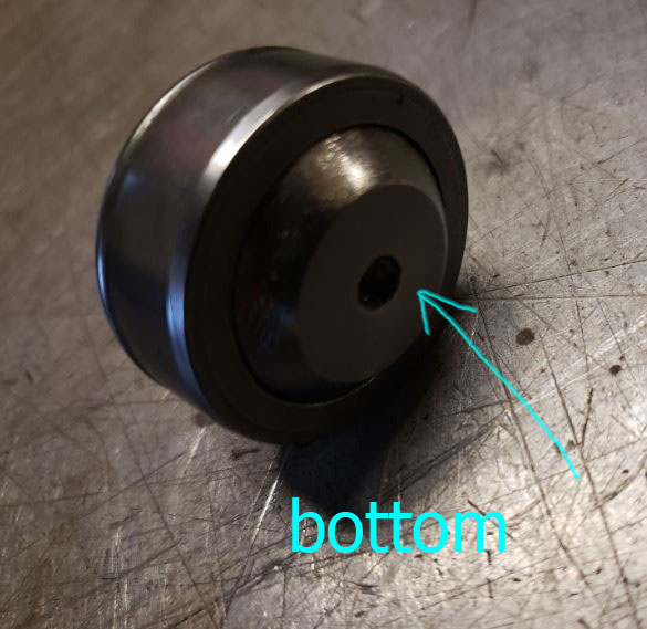

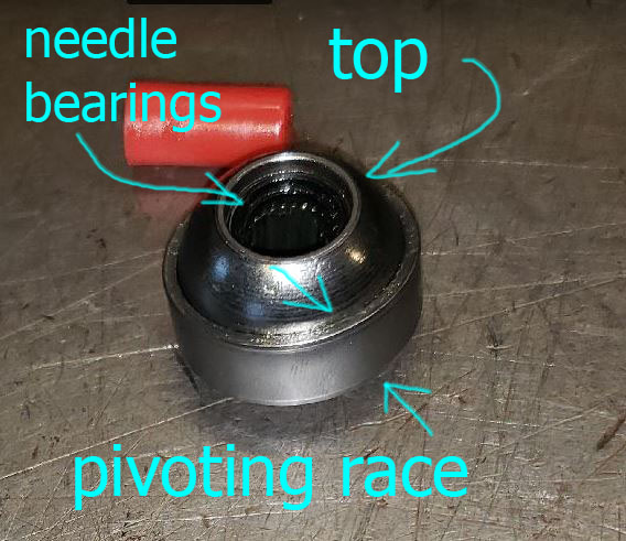

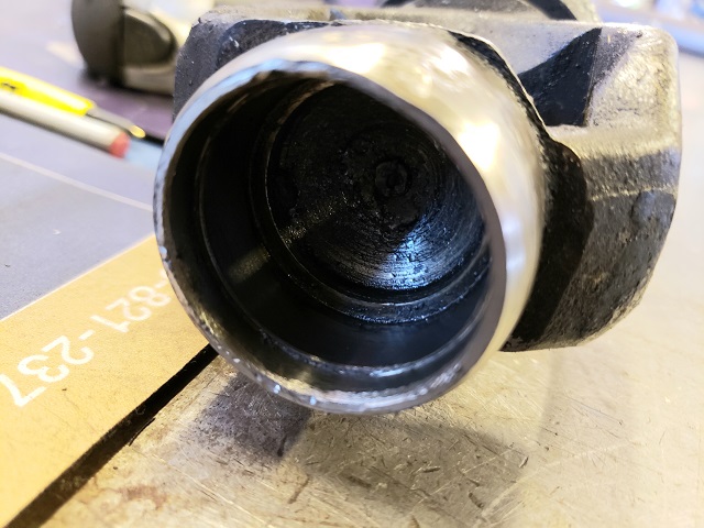

I spent a good amount of time face to face with these guys and got recommendations. Since its in walking distance of my house makes it easier too. Per your request and my curiosity also I went back there today and got some more info. They are real nice and brought out a new 3rd gen DC ball and pulled it out of the box and explained how it works and what they do. I put notes and arrows on the pictures. You can see the needle bearings, in the red packaging plastic is a spring. It rides on a stud/shaft. If the ball has no more lube and dries out it can wear out the bearing shaft. Where the lube comes into the ball is thru the hole on the bottom allowing it to get into the needle bearings. They measure the shaft thickness to make sure it is not worn out. The components they use seem of decent quality and I am confident in my exposure to them so far. This is their main line of business and seem to have a great amount of pride in workmanship. The DC ball is made by Neapco which has been around for almost 100 yrs.
https://neapcocomponents.com/
I feel even more confident in their work after getting more in depth with them. The true test will come out in my 1,000 mile per week use, yes I drive it that much. I just picked up another 3rd gen project and will need to refurbish another shaft. Its either rebuild or go for a Toms at this point. The way I look at it, seems lot of people don't want to mess with these DC balls, on the other hand someone that knows what they're doing can make it work properly. I figure, why throw out a shaft just because of a replaceable ball. Kinda like people throw out perfectly good expensive ignition coils cause the boot is dry and cracked and they have no idea you can buy the Denso boots separate for cheap money. Hope this helps.

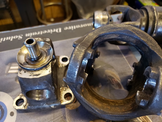

Got some more info for you. I went back there to get another 3rd gen driveshaft balanced, and they just happened to have a 3rd gen shaft on the front service desk at the time and I snapped some pics of it with the DC ball out.
Also I had them tell me what part number for the U-joints that are in the DC joint. They told me Neapco 1-5800. They showed me they can tell with a measuring gauge and they showed me how they measure it. I had them print it on my receipt.
The DC ball is just simple needle bearings as are the U-joints. Be cool if you can do a video on a DC rebuild.
