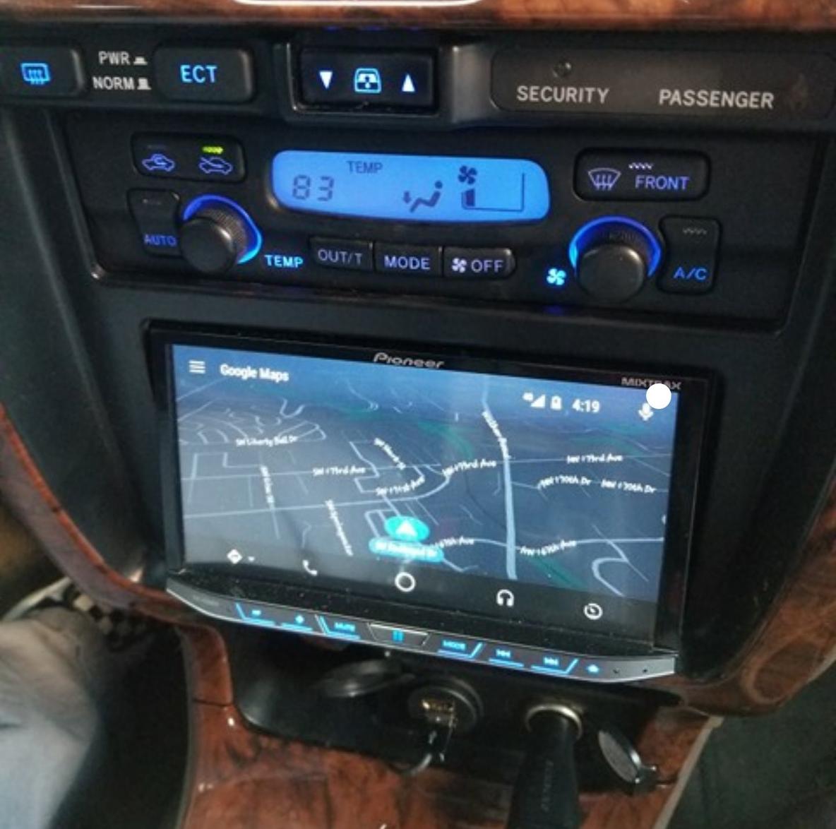

I'm going to directly go against what [MENTION=84796]Coward[/MENTION] said. I have a double din pioneer avh 4100 and it is amazing. I don't need to worry about fumbling with buttons or knobs because it come with a handy remote that operates whatever I need it to operate. Don't get hung up on small details when selecting a head unit. The cheap ones are crap and the more expensive ones are amazing.

I'm running Android Auto on the Pioneer AVH-4200NEX and it's awesome. The voice controls are great:
e.g.
"Ok google, navigate home" (my home and work addresses are presaved in Google maps)
"Ok google, search for chick-fil-a"
"Ok google, text Monica 'I'm going to be late I'm working on my car'"
"Ok google, translate 'The boy eats tomato sauce' to Italian" (no joke, it can do this)
All my Spotify music is available through it (unfortunately, the voice controls don't work for that). I wired up a back up camera too which is nice since I parallel park on the street every night, and the faceplate is removable so I remove it so it's less tempting for thieves. There's an SD card slot too, so once I get a dashcam if I ever need to view the video I can just stick the SD card in the head unit and watch the videos on the 7" screen.
I definitely recommend getting a head unit that tilts (like in the picture infantry503 posted) -- if it doesn't tilt, it will be very hard to see anything on the screen.

I'm strictly Alpine or Pioneer. I chose the Pioneer this time and got it so the buttons are on the bottom so it didn't take away screen size.
I second that. When it comes to head units, those companies are solid and usually have good interfaces & good button placement.
