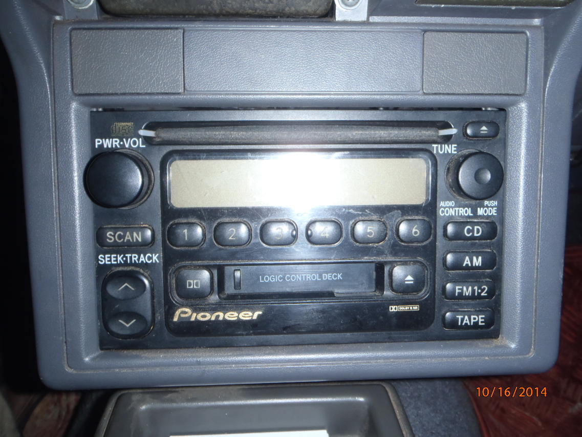

mine. while not "stock or available" for '87, this is a double din radio/cd/tape from a toyota of similar vintage. it fits exactly into the space, and uses the factory wiring & plugs. no modifications needed at all. although i don't know the ins/outs, supposedly an ipod adapter will also plug right into the other slots that are in this unit, too.
