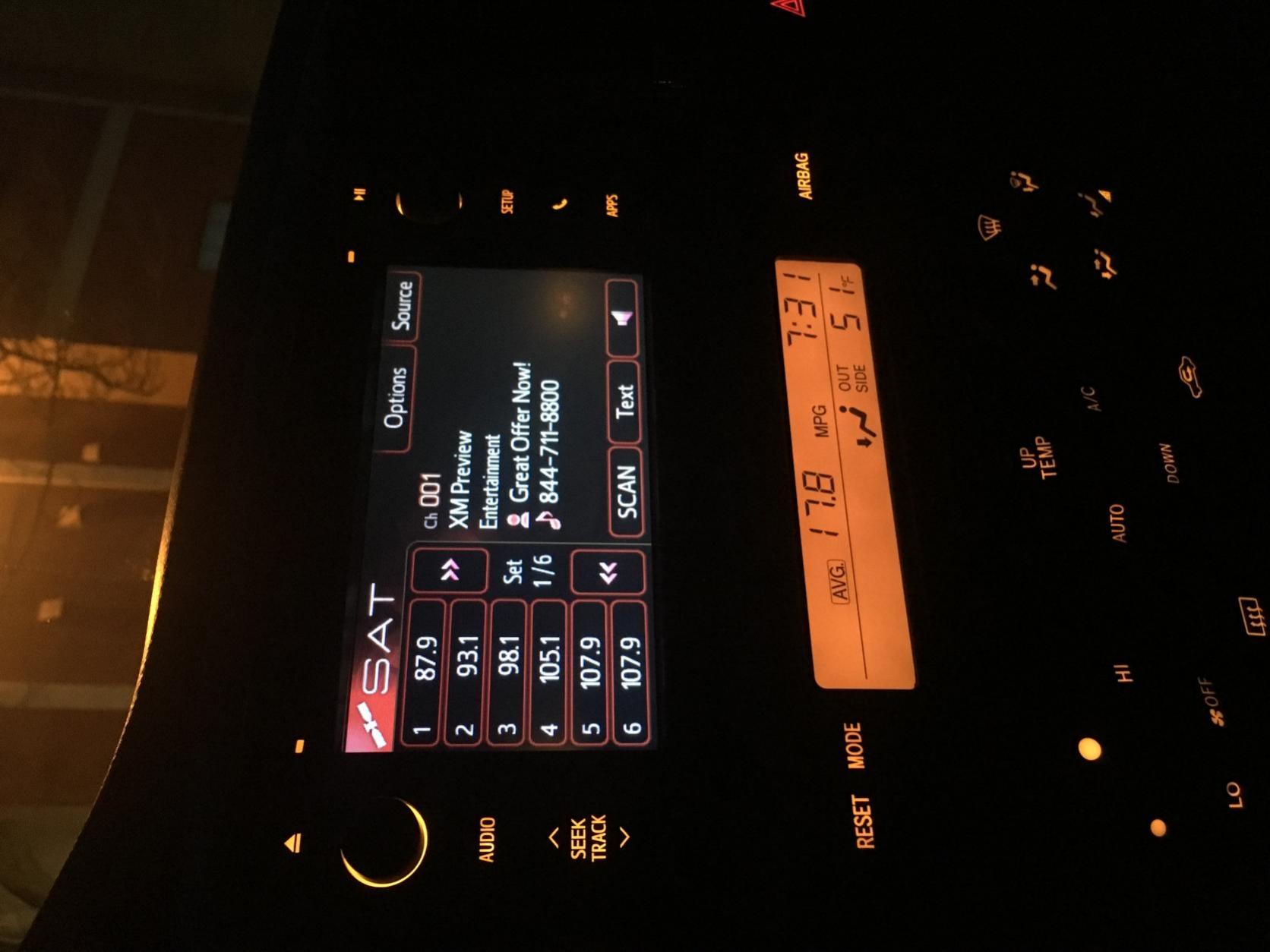

I went with a 2012-2013 Corolla head unit because I thought it looked "modern enough" without being overbearing. Seemed to fit better with the period of the car but added things like HD radio, XM, Navigation, BT music streaming, AUX, BT calling, USB charger etc. My 2006 already had the AUX input, but i added a USB outlet inside my console (it charges the phone and allows for entune internet function on the radio (traffic, weather, etc)).
Its a direct plug and play (with a few harnesses). No dash cutting required fit perfect!
I went and put the XM antenna in the spoiler, but i ended up taking it out because I had to many interference issues, so now im going to put a corolla XM antenna on the roof in the future.
Here it is (attached)! If you need some daylight photos let me know.
Other pros, it lights up orange, and it starts with TOYOTA logo (not scion).
Oh yeah its touchscreen if that matters to you.

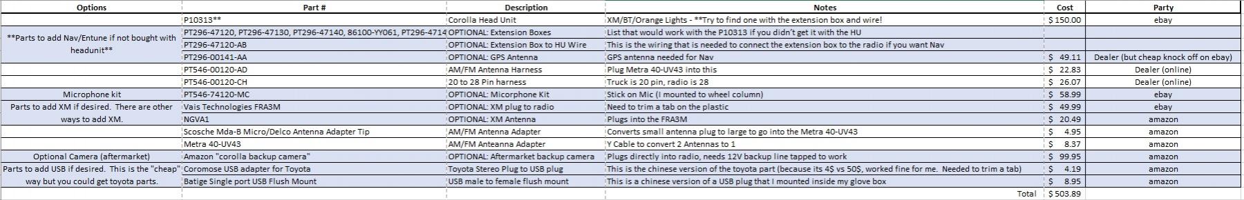

Turns out I had it on a drive!
A lot of options depending what you want to do. If you want hands free microphone, navigation, USB input/charging, backup camera. If you just want the double din to turn on and play AM/FM/CD's its really easy. Just need the radio, 28 to 20 pin, and antenna wires. That can be done for $200 bucks probably. The original poster would need the aux wires (sorry don't have the part number but he can sleuth the dealers parts and find it I'm sure).
If you want to add navigation and all the bells and whistles like I did, make sure you find a head-unit that already has the extension box and extension box harness. The sellers like to separate them and nickel and dime people. Shop around I did the entire thing for about $400.
Attached is the part numbers and about 5 minute searching up the costs again. SHOP AROUND!
