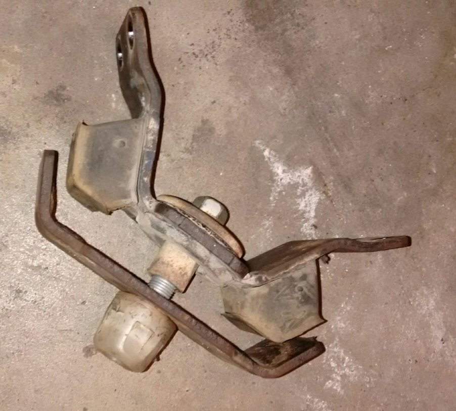

Replaced the rear engine mount on the weekend. Sure enough it was broken. If you don't know what you're looking at, the rubber parts should be connected to both the metal plates.
My drive line clunking is gone.
