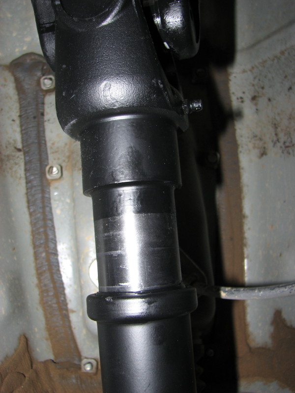

  • Slide Yoke (universal joint sleeve yoke) has ONE
I find a total of THREE
That PDF page is 2WD model. 4WD has one more zerk on main shaft and front shaft that is Slide Yoke which calls for Molybdenum aka Moly type grease. Clear as mud?

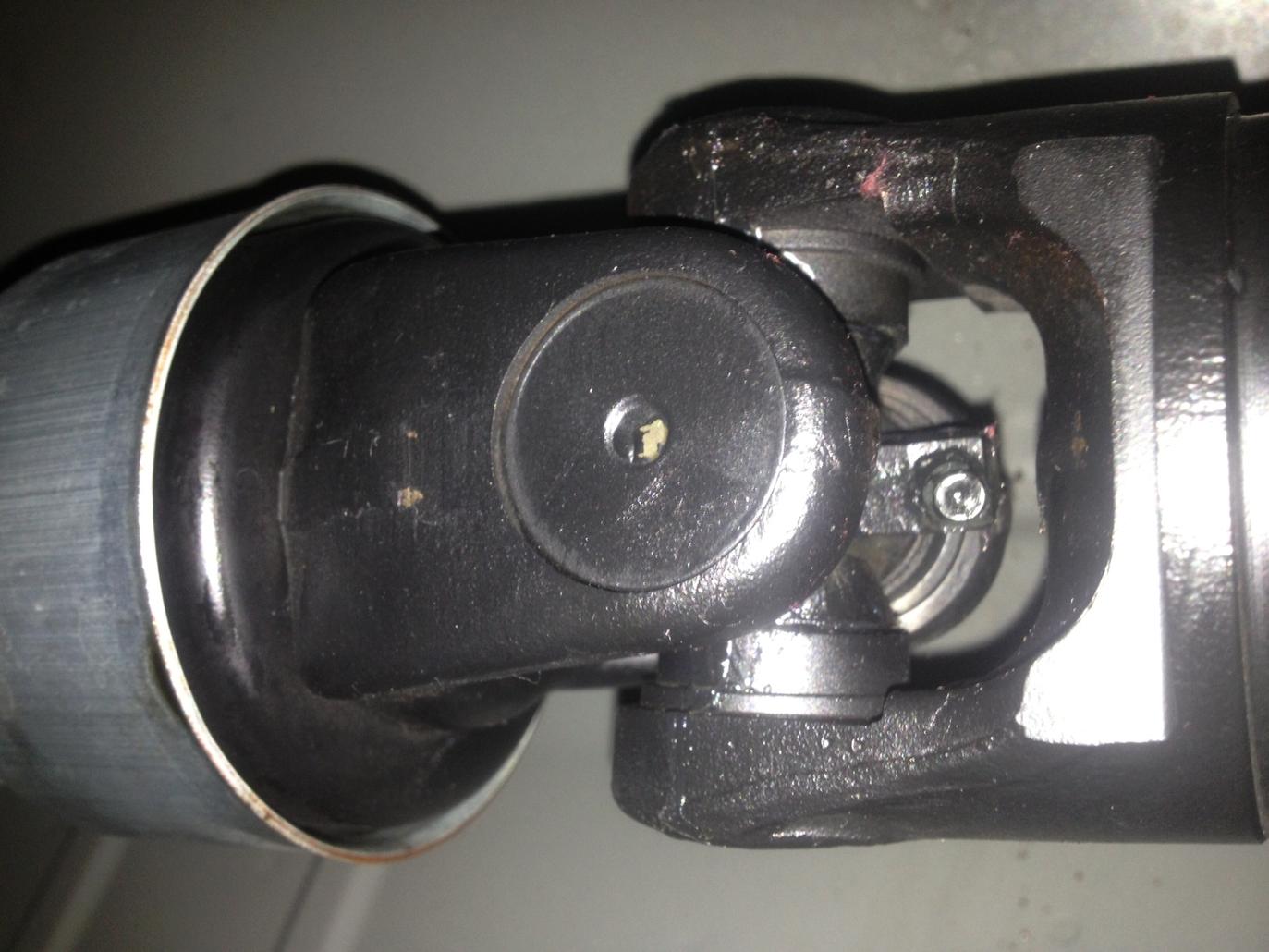

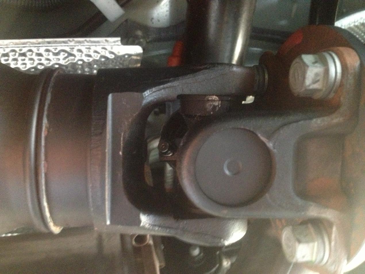

There are definitely only 2 grease fittings on my 2013 2WD SR5. One on each of the Spiders. First photo is the front.
