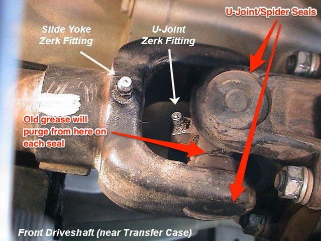

I "borrowed" this picture and made a few notes. Hope this helps! There are a total of 4 seals - each U-Joint Zerk services two seals. The photo only show 2 seals and 1 zerk but there is another zerk on the opposite side.. somewhere...

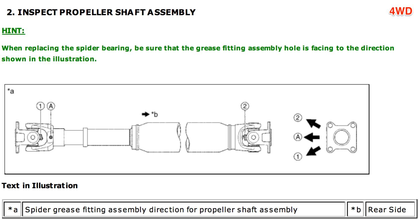

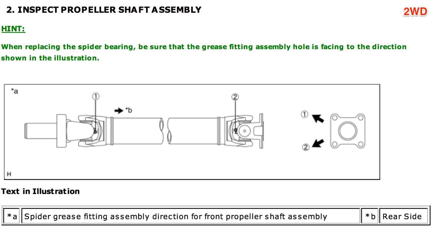

In consulting the repair manual, there does appear to be a difference between the 2WD and 4WD prop shafts. Looks like the 2WD does not have a slide yoke zerk..
Thanks for the clarification between the 2WD and 4WD models. Also, apparently photobucket sucks now so I need to find another way to share photos. Looks like the 2WD model certainly does not have a slide yoke to lube. The other two spider zerks were easy to find and grease.
