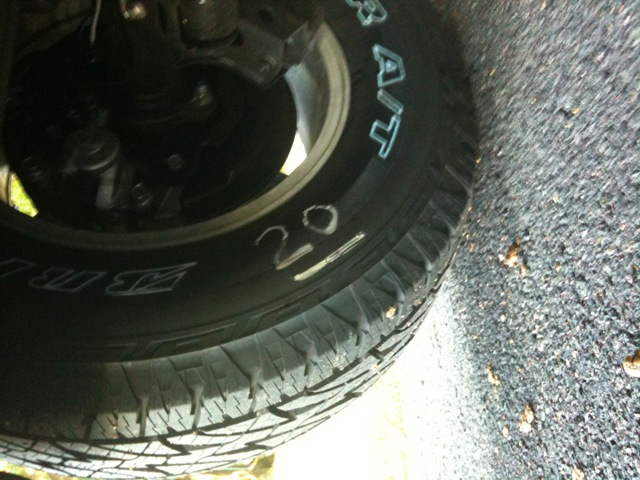

3 out of 4 high priced Michelin tires on my last install were found to have these problems. This was discovered after the balance and install, then many of the same symptoms described on this thread. I had the tires reexamined by a more caring eye, and discovered the problems. All three tires were replaced immediately, no more problems.
The dealer (that I will no longer go to) apparently tried to do something right even though I think they had a different motive. They were the one's who steered me towards it being a bad tire so I replaced all 4. Yesterday, they asked if I still had the stock tires because they wanted to see them. I said no, you told me they weren't covered under warranty and suggested I replace them, Firestone sent them back under manufacture defect. They said that the tires were out of balance...again. It appears they marked the inside of each wheel with the road force test results. This is from my left rear...
