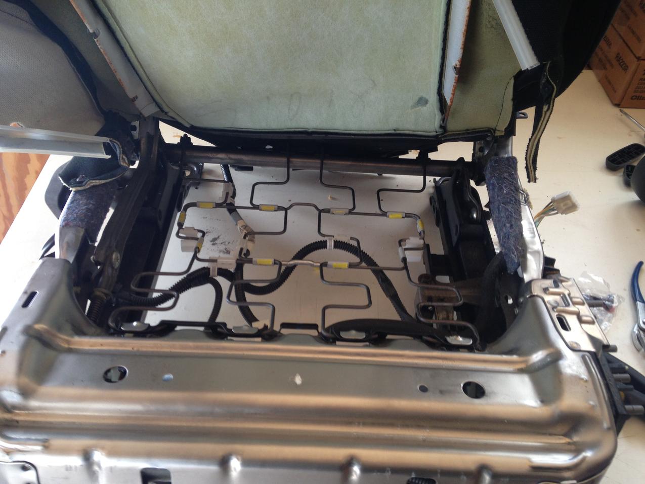

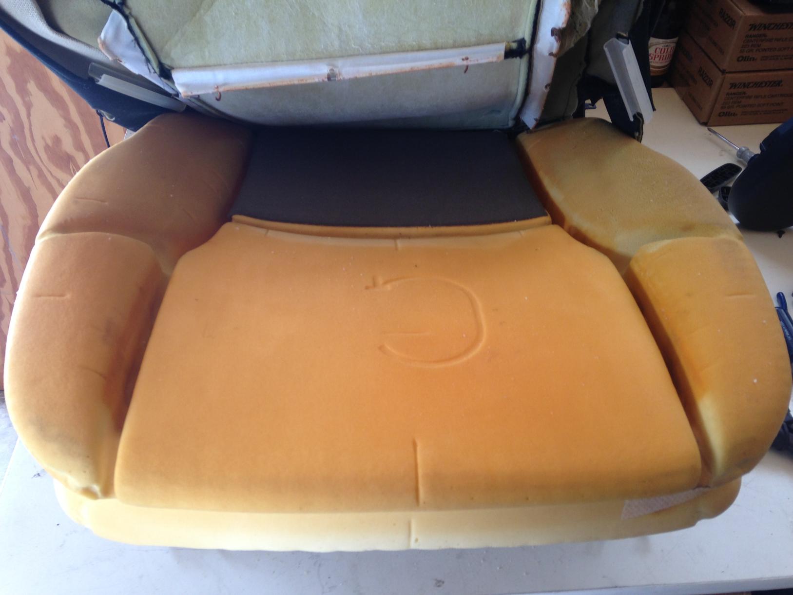

Based on a couple of suggestions I read about (not sure if they were both on this forum or not), I decided to shave some foam off the underside of the seat and add/or add some washers under the front seat bolts to raise the front.
As anyone who has ever installed seat heaters knows, taking a seat apart to expose the cushion can be a pain in the ass, especially with those little hog rings or whatever they're called. Fortunately, I had done this before.

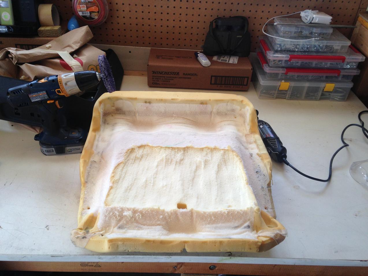

I got to the cushion and used a sanding pad to scrape about an inch of foam from the bottom (there's plenty to spare).

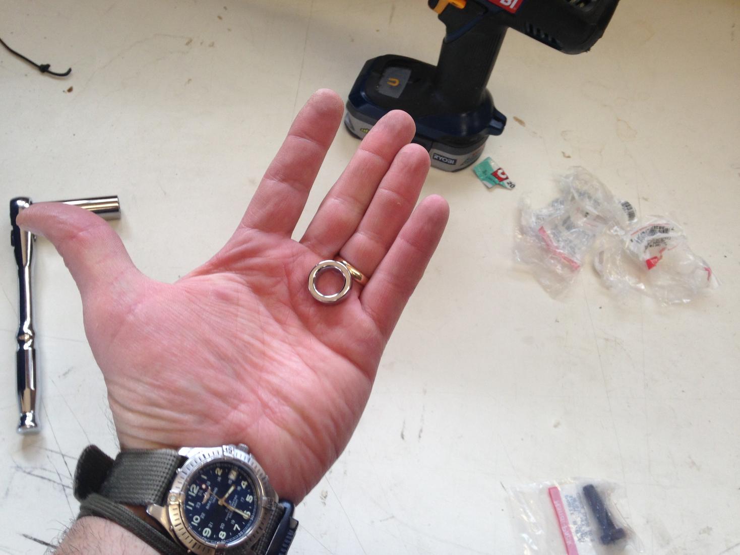

Then I put the seat back together and used a couple of the spacers I Menard's to raise the front part of the seat about a half inch.
Overall, it lets me a sit a LITTLE bit lower, but not too much. I'm still looking for a way to drop that rail. It looks like there's a nice 2" space that it could descend into with no problems, but it would probably mean getting some new rails and modding them. So, anyone with any ideas?
