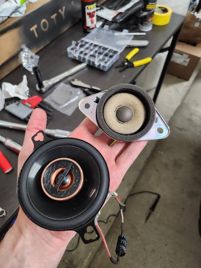

I would do either the kicker ones, the infinity 3.5"s (have to mod the bracket) or just look for some oem off ebay/local or something. I did the infinity's and I love them!
So if I replace with an OEM Is there anything I can do, besides making sure the volume is not to loud, to prevent the speaker from blowing out again?
Probably not, look at what it's made from. I almost put my finger through mine just feeling it when I took it out.
