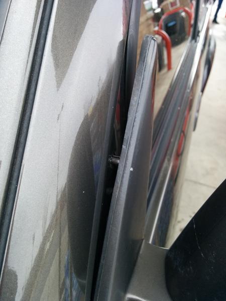

The driver's mirror seems to have broken free from its top anchors. Any idea how it attaches and how to gain access to the back?

I wouldn't wait too much longer. Looks like the assembly pin is all that's holding it on from the top.

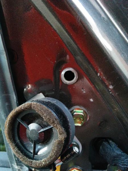

Well, I fixed it. And I broke it.
Didn't have to pull the door panel off. I just loosened the top inner retaining pin and popped the tweeter cover off. All 3 bolts were loose.
However, when I popped the tweeter cover off I think the tweeter-cover-pin-grabber broke. The top pin on the tweeter cover isn't grabbed by anything in the door anymore. I'm guessing something broke off the back and fell inside. The tweeter cover is just sitting there now.

The part that I broke isn't the cover. It's the part in the door that the cover snaps into. The cover side of the snappy connector is a ball on the end of a stick. The ball pushes into a grommet, or a bushing, in the door. That damn thing broke. What I'm left with is a hole that the grommet used to be, that is far too big for the ball-on-stick that's the cover side of the clip.
I think I'm going to try duct tape. I can fix damn near anything with duct tape. I'm going to wrap a narrow strip of duct tape around the ball, increasing its diameter until it becomes a tight fit into the enlarged hole.
