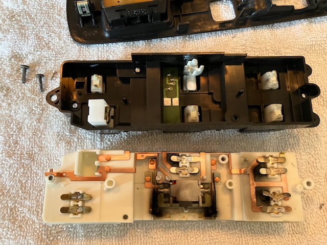

I had similar problem - window stuck in up position and all other windows and locks worked OK on my 97 4Runner. I removed panel and checked motor was working with backup 12V jump battery. I removed driver door switch assembly, disassembled (be careful lots of parts, lift from topi) and cleaned contacts (per other forum posts). I reassembled and reinstalled switch, driver and all windows are now working, auto down on driver also working.
97 4Runner Driver Switch - before cleaning
A photo of 97 driver window switch (dirty contacts) before cleaning with alcohol and cotton swabs. Note, there is a small spring that can fall out of the front side of window lock switch.
Photo attached
