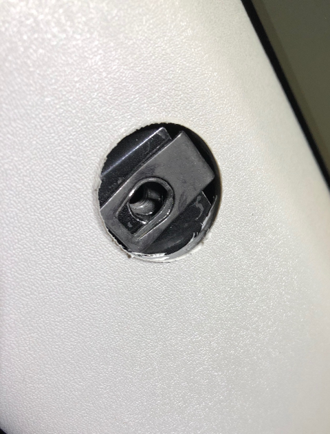

The Kit comes with custom bracket that you mount to the "A" Pillar of your vehicle using two self-tapping sheet metal screws. He provides a paper template that helps you line it up and step by step photo instructions printed out.

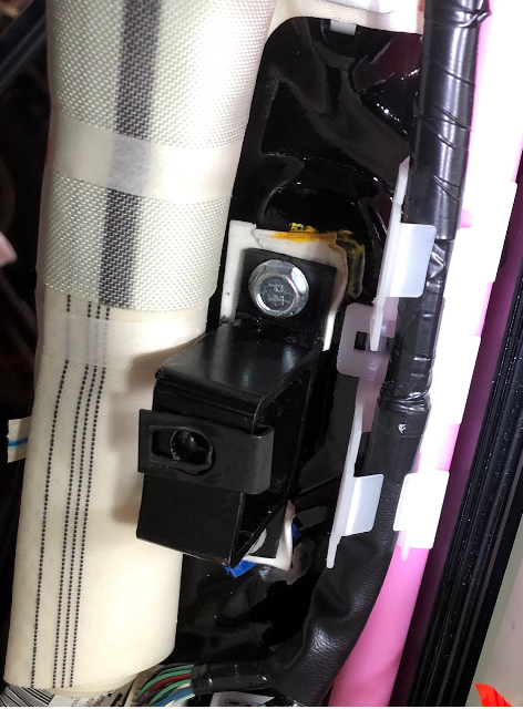

You have to remove the cover plate on the A-pillar that says "SRS curtain Air bag" under there is a bolt and the top of the handle mounts there. the bracket mounts at the bottom location to attach the handle there.

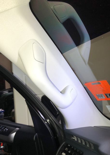

I installed this mod and I can tell you it is very strong and feel comfortable it will not fail!
Drivers Side "A" Pillar Grip Handle Bracket
Drivers Side "A" Pillar Grip Handle Trimmed
"A" Pillar Grip Handle Installed

[MENTION=103267]Saker[/MENTION] - Thank you for sharing! I've replaced all 4 OE grab handles with the FJ handles and this driver's side A pillar mod will finish everything off nicely. Not to mention it's the one that will be most useful! I still shake my head and roll my eyes at Toyota for not putting one there.

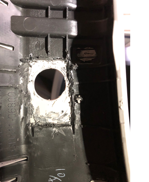

Your write up gave me the idea to use a similar but different method using 80/20 T-slot nut rather than riv nut. So yes... and no. I added to your post with my method.

Great write up/Mod and something I would like to have on my 2019. My 2004 4R had the pillar handle but not a handle above the door. However, I just have to ask, in regards to the A pillar air bag, does anyone know how the air bag deploys? The only reason I can see for Toyota not putting the handle on the pillar is due to a possible risk. Is there a chance that adding the handle will imped the airbag? I removed the cover when I installed my phone mic, and I couldn't figure out how it all worked (but I didn't really care too much at that point). I know most people don't know the answer, just thought I would put it out there.
