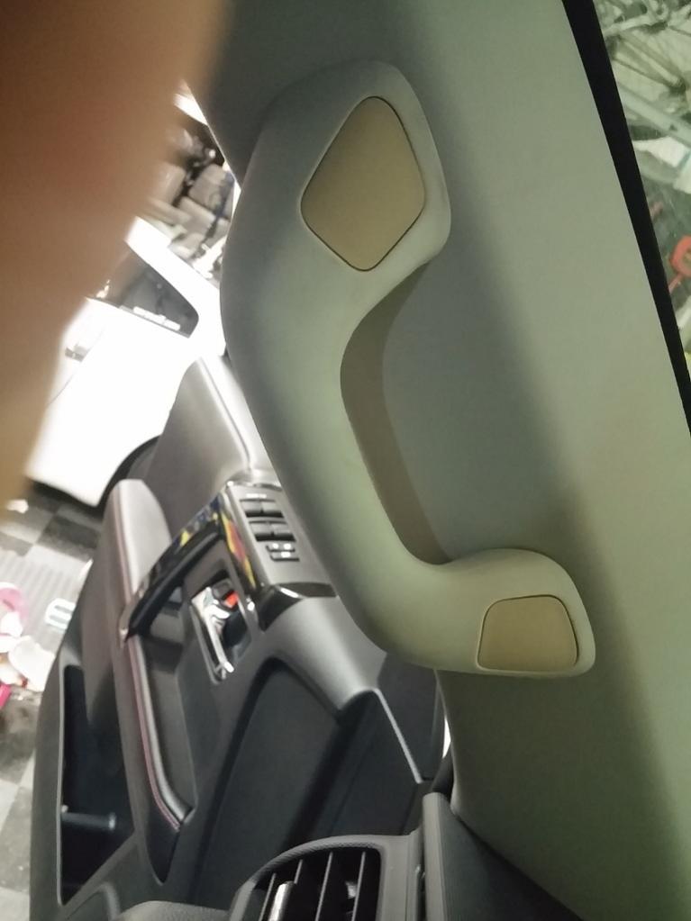

correct, the part numbers dont say colors - which is so difficult and why i really recommend purchasing from your local toyota dealership counter - if they get it wrong and order you the wrong color they will make it right and order again...but if you order from some toyota website then its much more difficult to return pay shipping, etc.
that happened to me - see the attached pic - when i did this on my own 4runner i ordered the handles and the two caps of the handle in what i thought was grey and i was sent a gray handle and two TAN caps.
so my own 4runner was like this until i got around to visiting my local dealer and using the numbers provided the parts counter guy was able to find the correct color part numbers.
yes - the handle is an OEM passenger side handle - which you flip 190 degree's and tada...becomes a drivers side handle....
