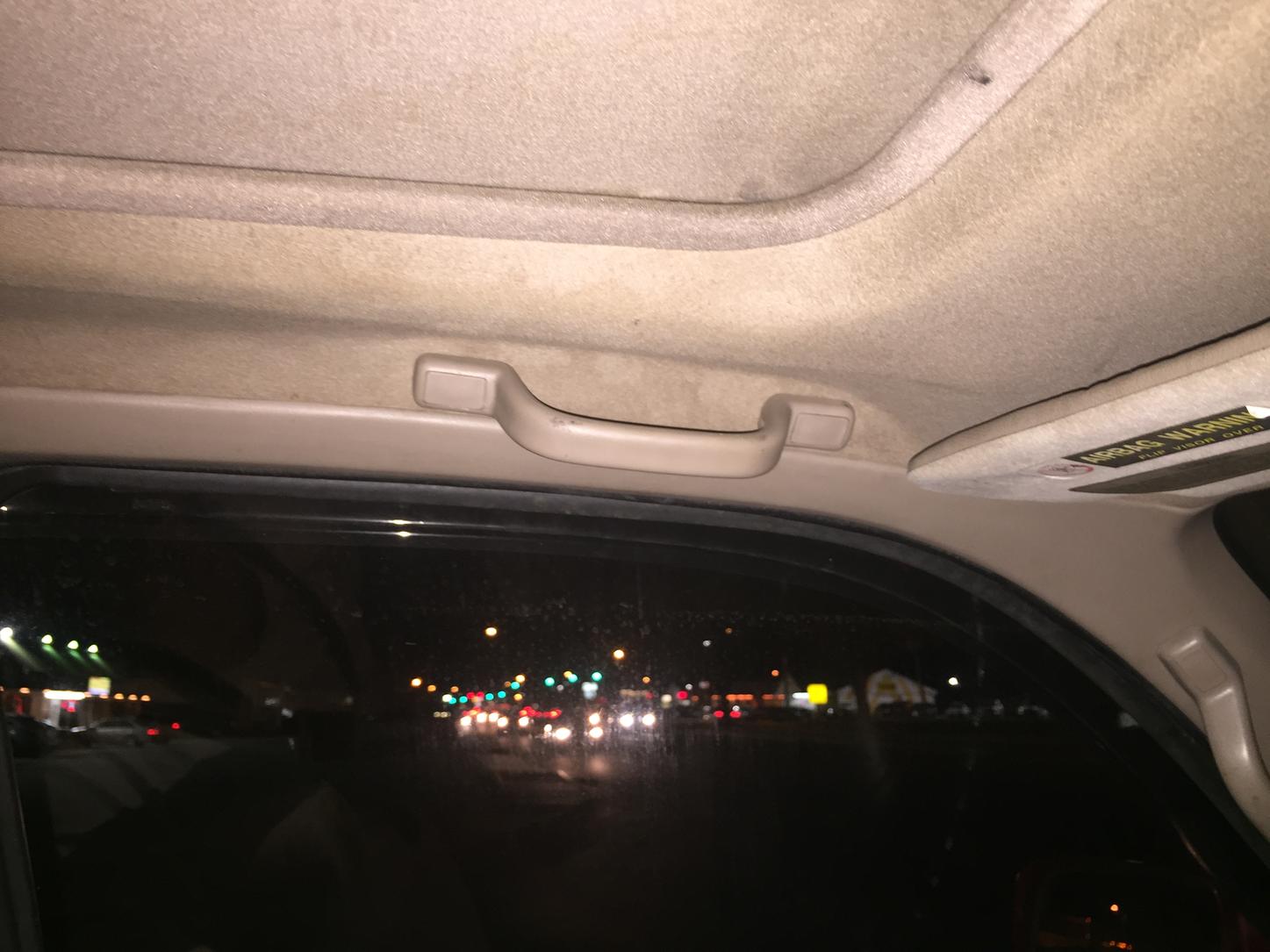

Drivers side hand grab
Myrunr2010
I stumbled upon this the other day when researching a-pillar gauge mounts. The holes are already in there. All I had to do was feel in the headliner for where the holes were, cut the headliner at the holes and install it. Less than 5 minutes. I've always wanted a handgrab above my head!
I felt like this was a hidden gem and wanted to share! Cheers!

I did this also, but seems to interfere with the sun visor a little bit when rotated to the driver's window.
I noticed I can no longer push the visor all the way to touch the window, but I'm ok with that sacrifice to have a grab handle there!
