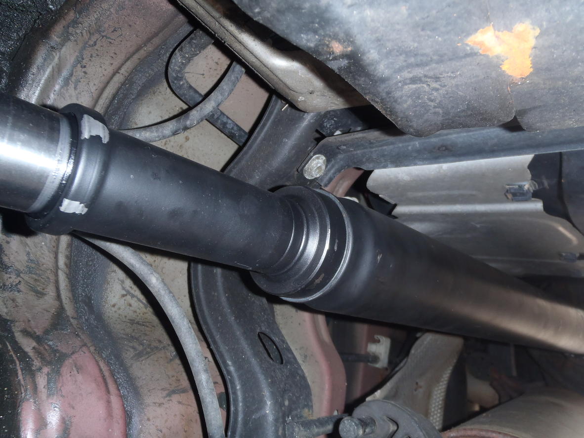

ok got the 4runner back and it DOES have a grease fitting at the ft slip yoke. i did not see any on the ujoints as before so those are probably sealed. i checked and it is the updated driveshaft. i did not have a chance to really drive it(i will this weekend). i will post pics later today(girlfriend takes it to work).
Interesting. So the part that would affect the clunk still has a grease fitting but the u-joints do not.
Your historical contribution is appreciated. :cheers: Thanks for checking.
i double checked and the u-joints are sealed but the slip yoke is not. on my old shaft the u-joints were greaseable. here are some pics of it taken a few hours ago:
