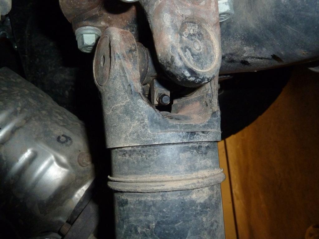

Ok, not my zerk, but for reference.....this zerk from the 13th post of that thread you linked is factory painted over and flat on top, you can't see the lil ball in the middle, correct?
My front one didn't look like that, you could see the lil ball bearing in the middle of the zerk meaning the flat paint top has been punctured by grease gun? Amiright? I can maybe post a pic later, just did a quick check...
Went from the front diff to the middle transfer and I couldn't really see a zerk there, one was pointing up couldn't view it, but I did see the part of the driveshaft that expands and contracts there was grease there, had to be fresh. Nice kind of metallic grey like color. Just a little bit of it.
^thats' an example of the part that "expands and contracts"...whatever that's called, where you see the fresh steel. Mine was lubed up.
