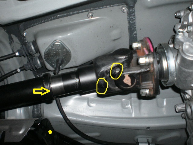

Attached is photo yellow arrow shows the edge of the seal to which I make reference. You can see where the paint is worn off so it much he moving.

When I did mine, it just started coming our around the zerk fitting (i.e. your bottom circle); not around the "slide area" of the drive shaft (arrow).
I was able to get quite a bit in when I did mine. (it had spent a good bit of time in the water before I regreased everything.)
