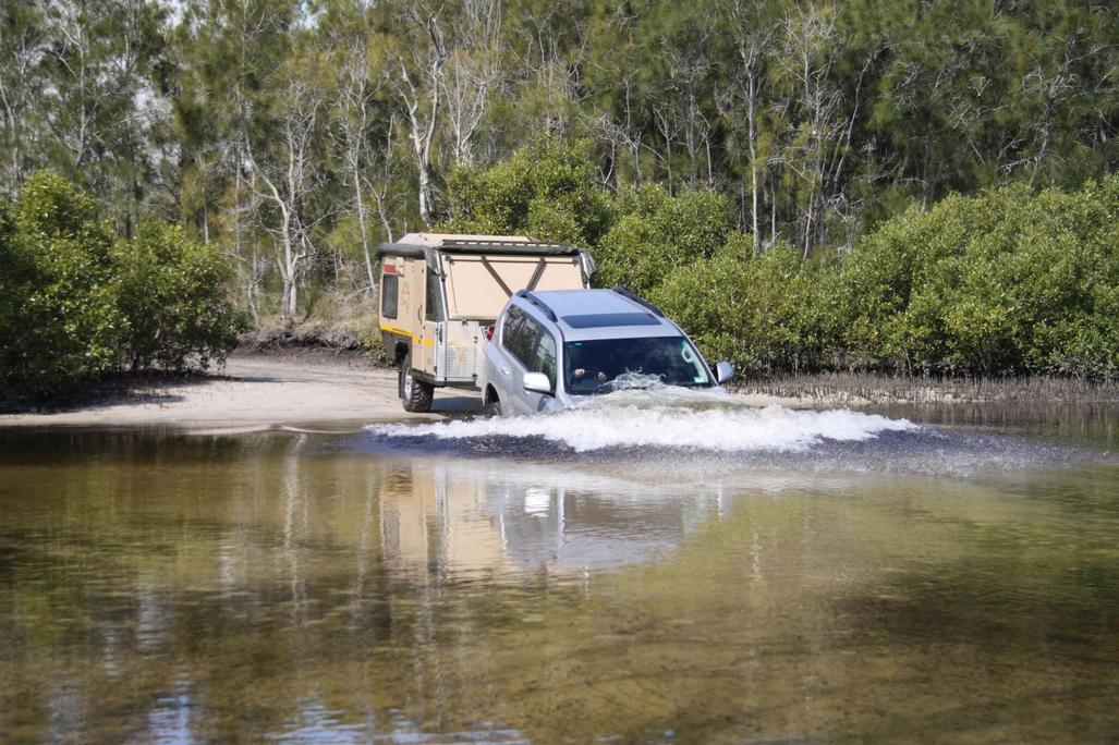

Here's a picture that I find interesting.....no snorkel visible.
In my mind, I'm guessing this guy will have a problem...based on the bow wake, the angle of the vehicle, but most obvious, the water on the windshield...that's a deep ass hole.
I understand the concept of water crossings done correctly, but this picture doesn't strike me as one of them.
I doubt it made it across....but just my own opinion.

LMAO...My question is wtf does he think the trailer is going to do, act as a rescue buoy? Unless your name is Captain Nemo, I'd also advise against this with your Vehicle.
As a learning note this is why you walk water crossings first.

i've personally been this deep as i submerged into a water hole in the outer banks. once the hood went under water i floored it to pull out if at all possible. came out and no water in my airbox believe it or not

Why is he driving on the wrong side...

shiiiit, that aint nothin. Them Gall Boys would tow a 40' trailer through that.

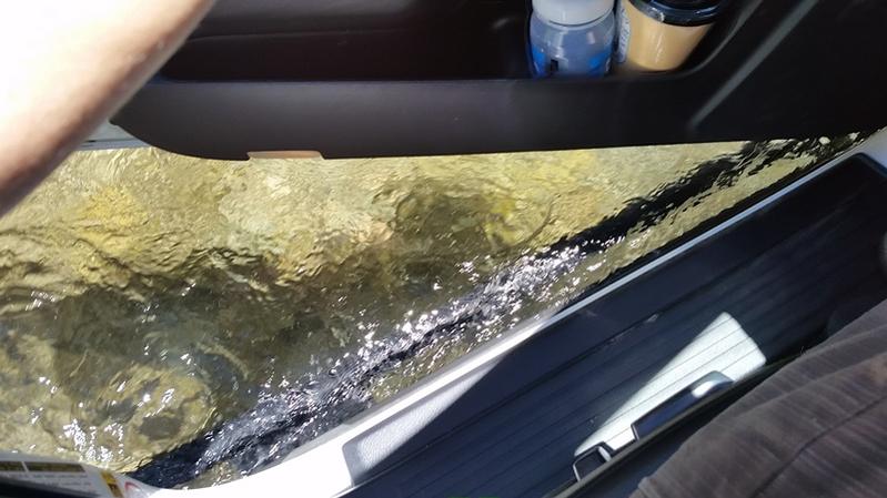

The biggest problems I've had over the years is the mess. Water and mud in the carpets is a HUGE PITA to clean up. Especially the thin gooey kind of mud that comes through the drains under the carpeting and gets in your seat tracks and such. It's just not something I ever want to try to clean out of my daily driver. Unless it's absolutely necessary, I'd find an alternative route around the mud/water. My personal stopping point is when the water hits the floor pan unless it's a very quick in and out where I won't get water inside the cab. Otherwise I've made a mistake and should be in my FJ40 or hiking.
This is my limit. It's a daily driver first. As much as I love to test the limits, as I've gotten older and lamer (or wiser depending on you view point) I accept my limits a little more.
