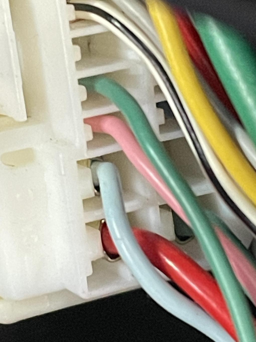

Know this is an old thread. Question though, I have torn apart the truck once again (prior 2016) and since I have it opened up thought I would do this mod. Took a look at the connector and at least to my eyes, I do not see any wire in the pin 5 position. Does this carry over to the 16's or is there a different means to accomplish this? Thx!
