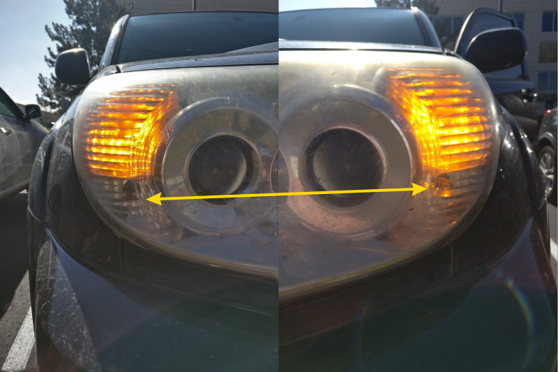

Hello - Im having a hard time finding the bulb size for the bottom DRL light.
Its the one out in the image below.
Thanks!

What year is your T4R?
The bottom ones are parking lights, which turn on with the stalk in parking light or lowbeam positions. The upper lights are the DRLs/turn signals.
For the ones you pointed out, they're 194A (A = amber), if you get standard 194 bulbs they're clear.

im just guessing here but wouldnt that be a standard yellow 194 bulb, otherwise known as a T10 LED bulb?
that is what is most often used for the marker lights on toyotas
The manual linked to above says its a 2827 - Parking and front side
marker lights bulb. Are you sure its a 194A?
the bulbs will interchange with 194 or T10 if you want the LED bulbs which i would recommend, so the 2827 might be a slightly different wattage or brightness so thats all you really need to look at is they are at least the same watts
they are push in wedge type socket bulbs and this is what they look like https://www.ebay.com/itm/Sylvania-2...ash=item46598f2f41:g:VkEAAOSw5cNYU1fF&vxp=mtr
I've done bit more research on this since from what you posted I looked at the Toyota owner's manual for your 2009 T4R and it actually doesn't even list the DTRL bulb, the bulb you listed from the owner's manual is for the parking and side lights bulb, from my research what I found is that the bulb you need is a 4157NA or a 4157A led, I got this info from the Sylvania website and also from a chart on all auto bulbs.
https://www.sylvania-automotive.com/apps/vlrg-us/Vlrg/#sylvaniaProductsPanel
On this auto bulb chart click on "Toyota" in the listings and it will take you to the correct page that the Toyota bulbs are on.
https://images-na.ssl-images-amazon.com/images/I/D1zn6z0GtSS.pdf
One of the above mentioned bulbs should be the one you need, but I would suggest pulling out the bulb in your T4R and checking which bulb is in there now!
