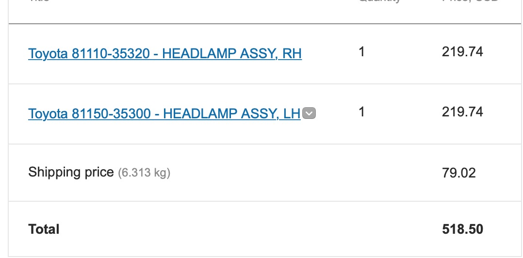

These are the part numbers I was using.
81130-35320
81170-35300
The above P/Ns are for the "Lens and Housing"
The below P/Ns (see screenshot) and prices are for total, complete new "headlamp assemblies"(everything including the bulb):
From my local dealer they're $204/piece plus $30 for shipping. I only bought the lens and reflector though since I'm going to mount them in my current frames to save some money and upgrade the bulbs.
