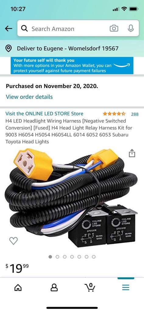

This is the product @%1; linked us too. It was plug and play
Not saying harness is good or bad deal, to each their own.
Resistence checks of Relay coils contacts bases, 3 prong connectors Ohm'ed out as good as what you get at autoparts store. I'll tweak the rest.
Seeing other's responses I wonder if this particular product's quality has degraded since I bought mine a year ago. My wires are stout and work fantastic but obviously the ones that were shipped out recently are less than desirable. I've seen this happen with Amazon items before where all of a sudden their quality goes to pieces.
I’m happy with mine. At the minimum I spent 19 dollars to have a basis to make it better. Prewired relay bases from napa are something like 25 dollars.

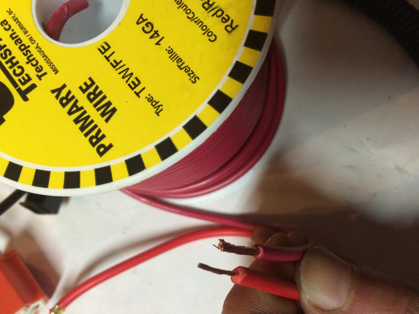

And just so everyone knows I'm not smoking to much electric lettuce, here is a pic of the main supply wire supplied in this harness beside a 14AWG, and yes the strands are thinner and the count lower making this mAyBe 18AWG but I still think its 20AWG. I will say the relays are nice and have been weather proofed which is hard to find.
Sorry for the gigantic pic, no clue how to resize this.

Wow. That supply wire is bonkers.
