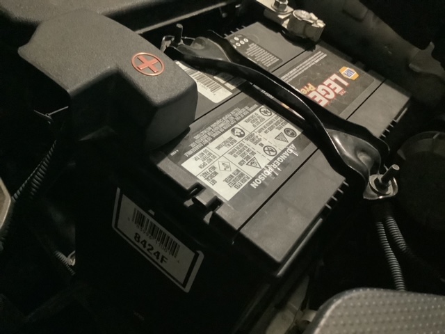

I put in a Napa Premium 24f this spring. It has about 200 more Cold cranking amps than the Panasonic.
