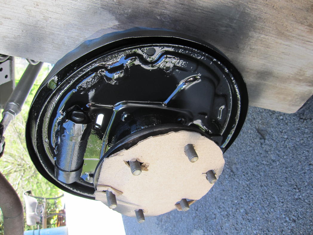

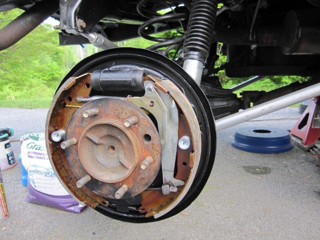

I just did mine in May, here are the cleanest brakes in the NE! LOL I used rust converter & paint because they looked as horrible as yours.
