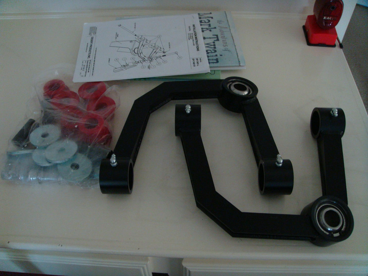

Hi fellas does anybody know if the Downsouth motorsport uca's will fit a 2015 TE 4r? these came off my 2011 tacoma that i had an ome lift on it. they really don't have many offroad miles at all. if i don't have to buy uca's that'll be a bit of help to my wallet. as i'm trying to save my coins for a lift for my 2015 TE.

I would say yes.
My TC UCA's were used for my Tacoma, FJ and now 4R.
i've been searching google on dessert product uca's but nothing really comes up. i don't think they sell them anymore. just by looking at them they seems to fit.
yes they fit. just called the good people at downsouth motorsport and they confirmed is that is a fit. these arms are not made anymore. i'm trying to do a overhaul with bushings uniball and the cups. they have everything but the cup. anybody know where to get these?

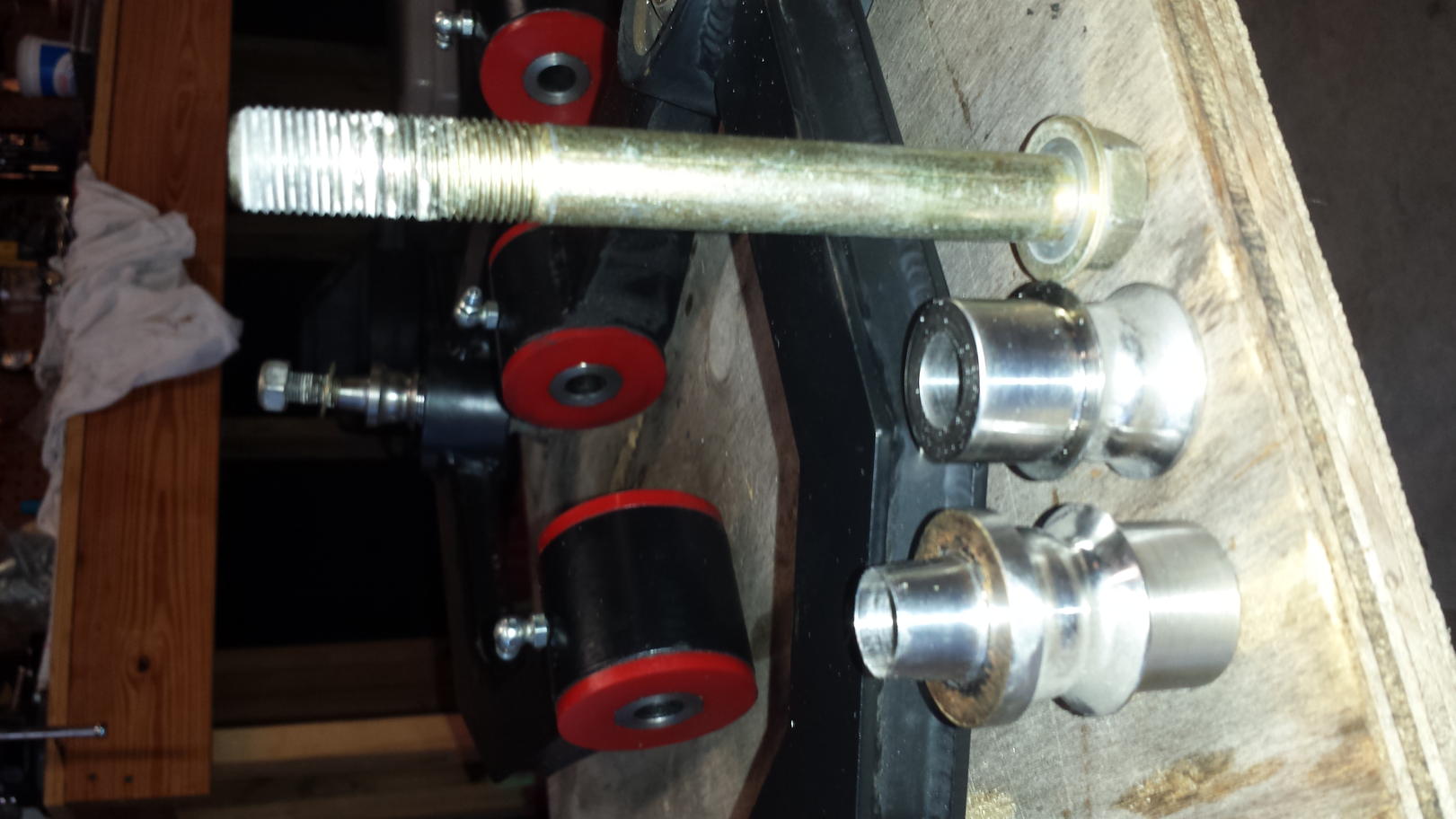

yes they have the uniballs and the bolt but i'm talking about these.

Why do you need to replace them?
They look suspiciously similar to the Total Chaos ones...
i took them off my 2011 tacoma. i'm soon doing a lift on my 2015 4runner wanted to do an over haul of the uca's before intalling them. if i can't find them i'll just reuse them but i have everything else but those spacers.
They're called misalignment spacers and I know for a fact ORW has them as
I bought a few from there when I rebuilt my allpro UCA's for my Tacoma. Kartek should have those too but can't be positive.
