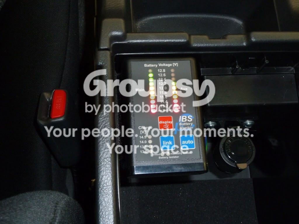

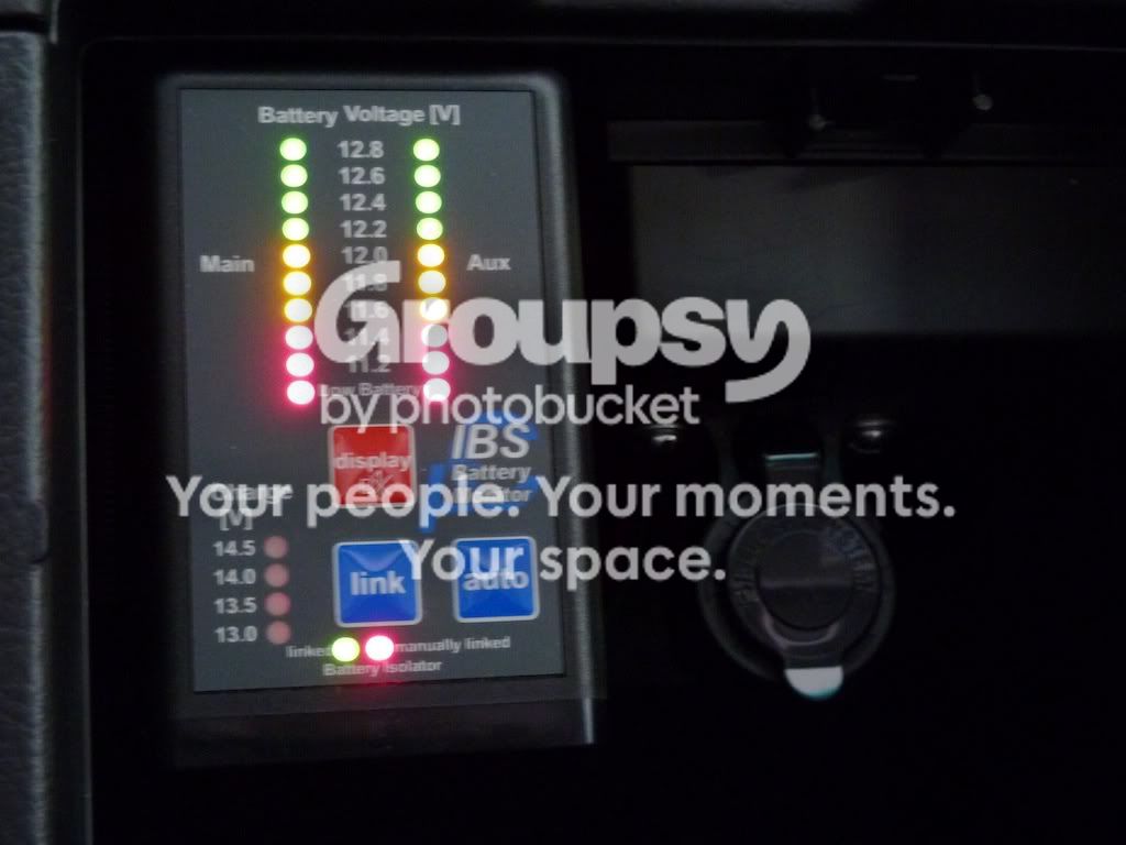

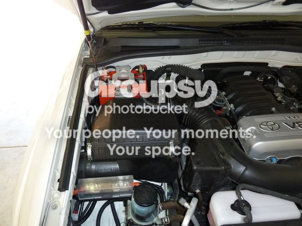

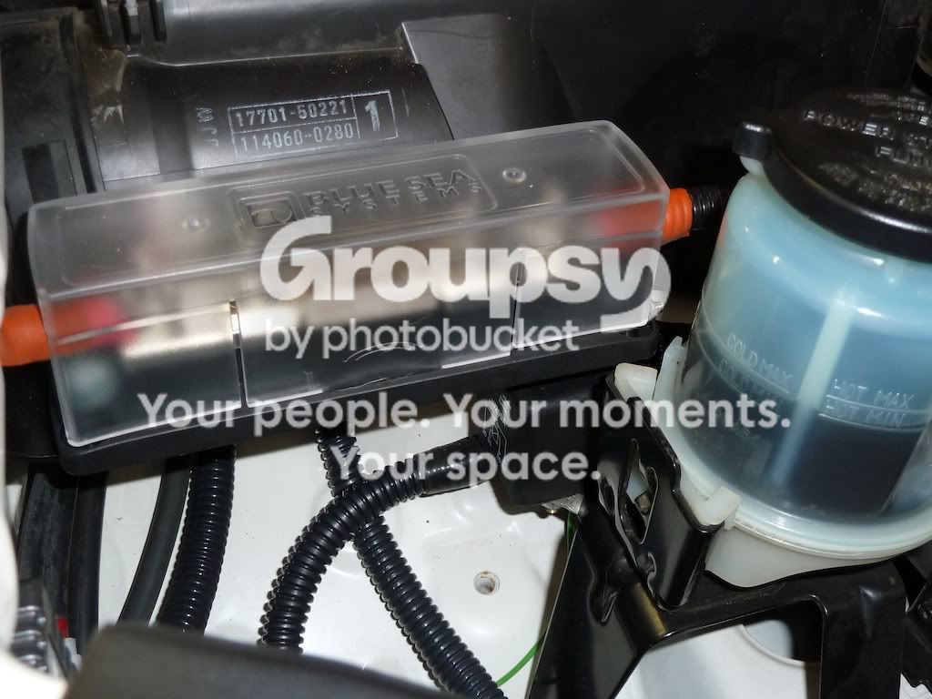

I've been using an IBS Dual Battery System with an Odyssey PC 1200 MJT-L secondary battery for about 3 years. Yeah, its a little pricey but it has worked flawlessly. It automatically links the two batteries if the engine is running or if the trickle charger is hooked up. When the engine is off it'll automatically isolate the batteries. You can manually link the two batteries if you need extra current. I highly recommend it.

The IBS controller/monitor mounted in the center console. I also installed an additional "constant power" 12 volt socket in the console.

The monitor showing the charge status of both batteries.
