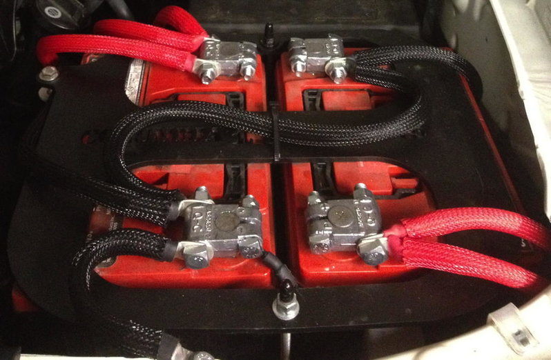

I plan to wire this in parallel, upgrade the alternator and big 3/4. I plan to run one 42" led light bar, four fog lights (ditch and bumper), two spot lights (bumper), one 30" me lift bar (bumper), rock lights approximately eight or ten and two 6" or 12" led light bar (rear). All lights will be ran from an Aux Fuse Box (Bussman/Blue Sea)( I'm still trying to figure out how to wire that and all parts needed for it)
With all that being said here's where my first question comes in. So I want to go with two red top optimas, two yellow top optimas or one red top one yellow top. Next I wish to wire like this:
image-3-jpg.162765
In regards to the picture if anyone can explain where all the wires.go to that will help greatly​.

Would I need to isolate the batteries or is running them I'm parallel still ok?
You really should get an isolator. Running one battery down (ideally a deep cycle variety) and still being able to start the car when you're way out in the boonies is one of the reasons to get a dual battery setup to begin with. Parallel will run down both batteries.
And charging parallel batteries can be a little iffy, unless they're very similar in terms of type and capacity. Otherwise you might tend to overcharge the weaker of the two and ruin it in fairly short order.
As far as I remember a good isolator will maintain the charge of the isolated battery.
