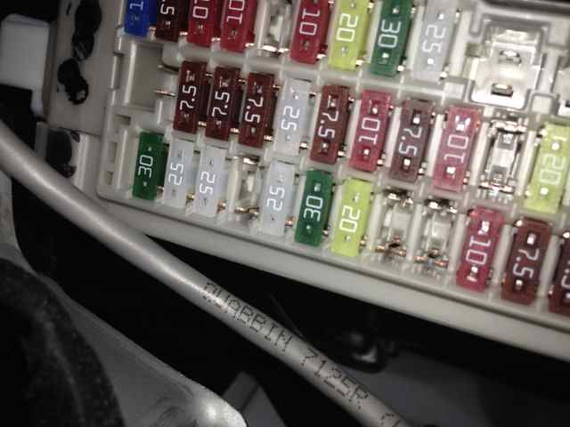

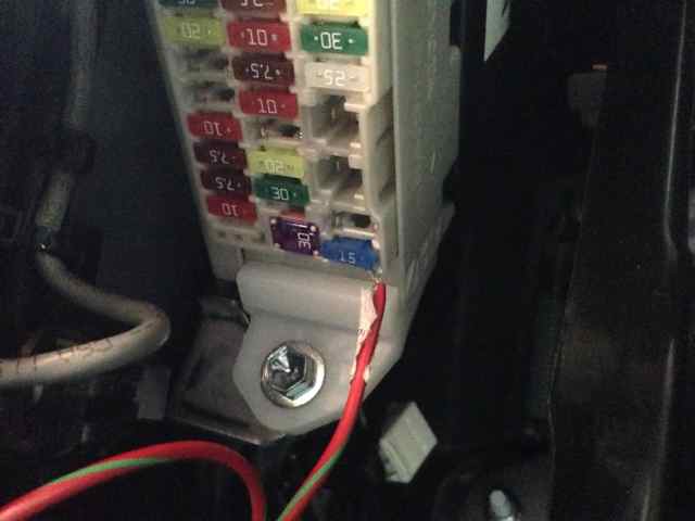

Ok. For the folks who have ben following this drama:
The array is connected and working as designed EXCEPT for what Ducmonsta has recognized: the elusive "4th wire". i will trace and give info ASAP. This could explain the constant parasitic draw: the power is always on to the solenoid, just enough to add the constant drain........
Here are the photos, under the dash. All I have to do is swap the "green/red" wire to a 12 volt fuse spot. We're getting close! Thanks to LXRunner and Ducmonsta and others for getting me this far.
PROBLEM SOLVED!
Thanks especially to Ducmonsta for solving this one and walking me through it. I needed to unplug the red cable which was not functioning as it was supposed to in the fuse show above and plugged it into another fuse circuit (the 10amp KDSS).
Glad to help. Remember, you should replace that particular fuse with a "tap a circuit" type of fuse holder. Just make sure you bring a fuse with you so that you can compare the sizes.
