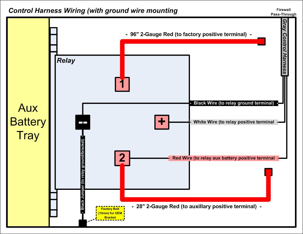

In post #38, boodabill explained, that wire is below the big one on lower side..., and soooo, per his diagram it's permanently connected to battery positive terminal....

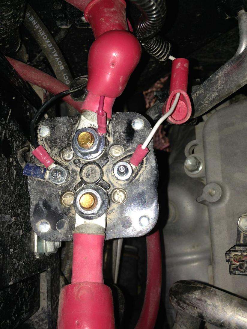

There are supposed to be a total of three wires attached to the solenoid. There is a forth wire at the opposite end of the harness that is supposed to be connected to the 12v ign source. Mine looks like this. Not my Jeep by the way!

I think it,s clear from diagram on post #40:
One of the pin on Relay is "bolted" to Ground, and in same time provides Ground to light up Switch LED by Black wire. The other pin on Relay gets +12 from switch (when it,s ON) by white wire. Red wire serves to apply +12 to the switch - preferably from IGNITION fuse (but it's not.....per diagram :sorry: ).

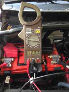

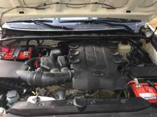

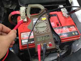

Here is a photo of all the wiring on my relay. Also, in about 12 hours the power in each battery has gone down from 12.17 to 12.0. It's still draining, and unless i start the car it will be gone in a about a week. guess i'm damaging my batteries...

Close up of relay below. Can someone kindly sum up what people we think the problem and solution is?
The small red wire is on the factory positive terminal, although it's on the top, not the bottom. Does that matter? In other words, looking at the diag. below, 1 an 2 are switched.
Yes it matters. Switching 1 and 2, effectively switches which battery is the aux and which one is the main.
In that particular case it does not matter, because any way red wire becomes hot at any time from one of the batteries, and may drain current throw solenoid if Battery switch is left in ON position, no matter what is Ignition key position.
