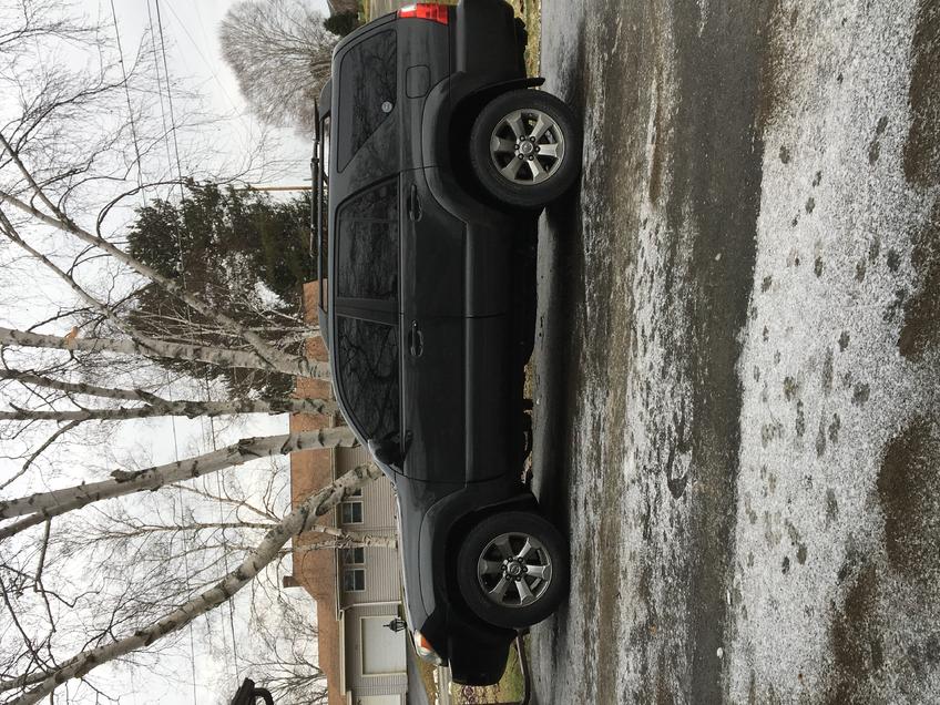

How she currently looks
My storage box

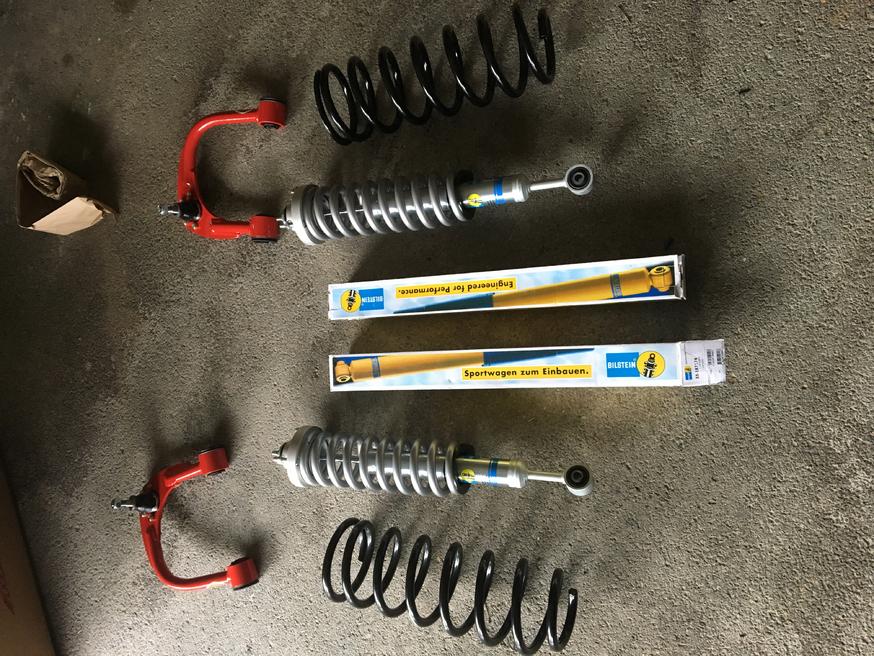

Took delivery of my lift kit the other day, it will be getting put on this coming Tuesday. My coopers and wheels showed up as well.

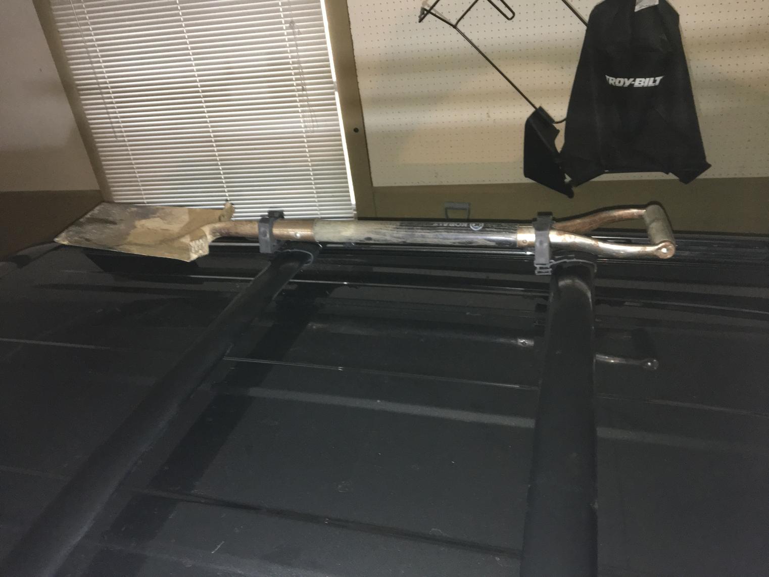

And today I mounted a shovel on my roof with the mounts I bought a while ago got the coming snow season

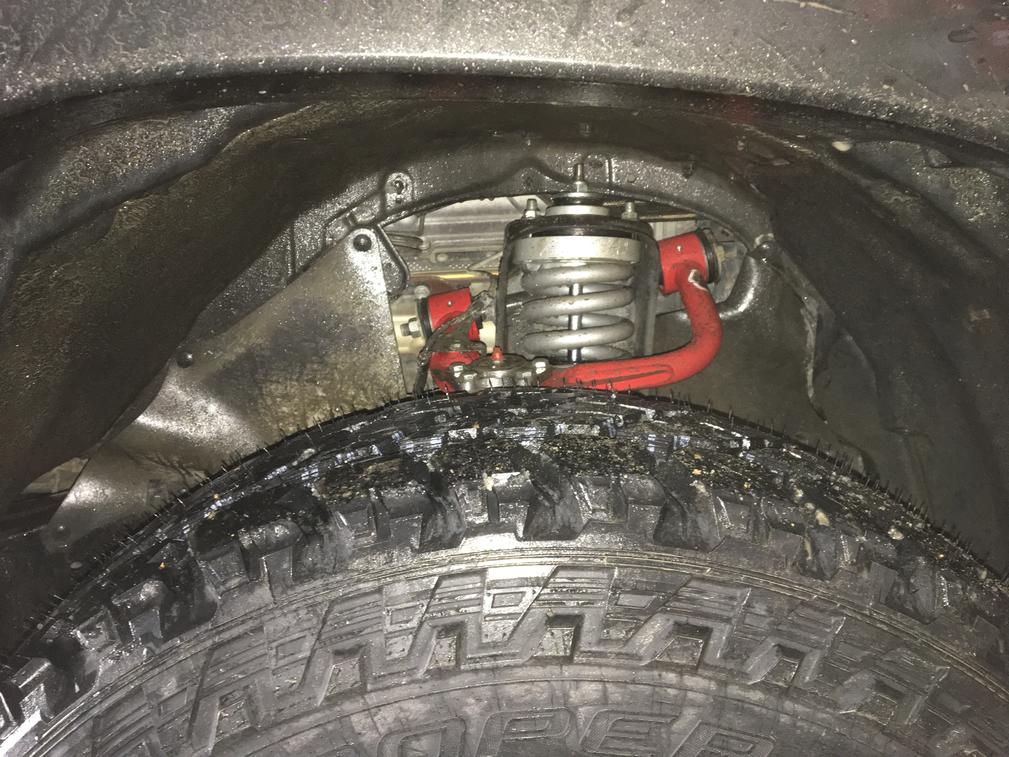

Lift kit gets put on today! I decided not to have the extra 1/4" top plate spacer installed but otherwise Ill have
JBA UCA's
Blistein/eibach coilovers with wheelers 1/2" top plate spacer for both sides
Sway bar relocate
Front differential drop
Superflex HD Rear springs with blistein 5100 shocks
and for tires Cooper ST max 255/80/17 with mb 352 wheels in 17x9

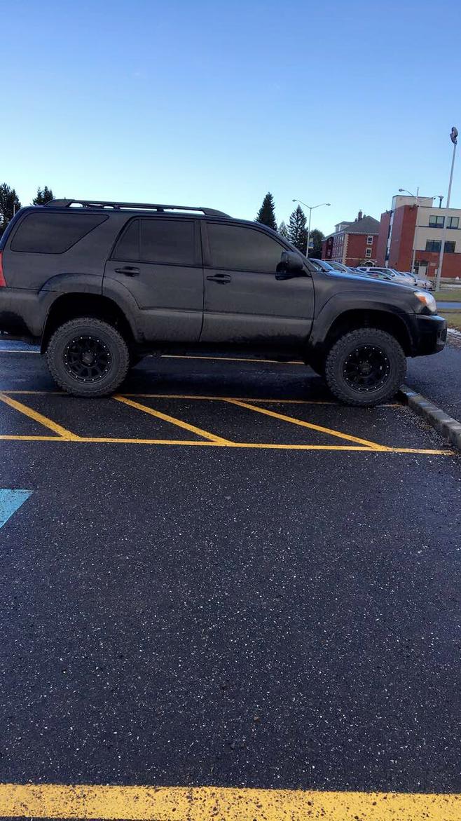

Lift kit is all installed and I love it! The ride is firm but not harsh and the suspension absorbs bumps supremely well! I am running no rear sway bar and i can just barely tell that i don't have it. The 620 pound springs seem perfect for the V8 engine. The Alignment guy had no issues with the JBA UCA's and everything was in spec when i left the shop. I will take it back in a week or so for another alignment.
My measurements for the lift are from the ground to the highest point of the fender arch, I took before measurements from hub to center as well but i forgot what they are now...
Front
Before 31.5 inches
after 38.5 inches
Rear
Before 35.5 inches
After 39.5 Inches

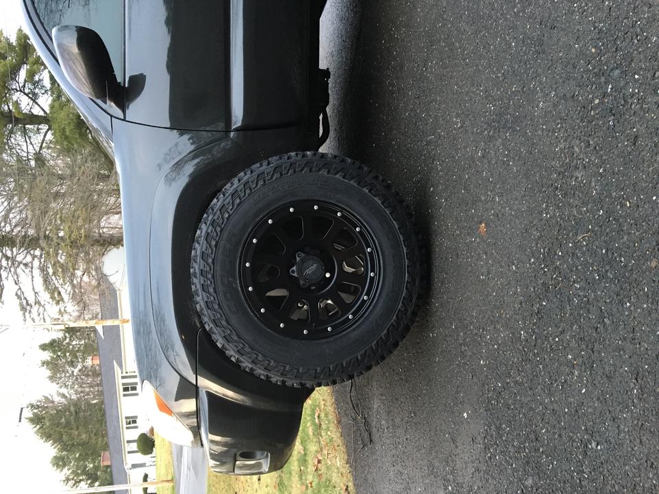

I had to remove my front mud flaps and trim the bulge off the fender liner on both sides as well. And it looks like a may end up borrowing a cutoff wheel from somebody to do the body mount chop on both sides. I think I will be running into some rubbing on it when turning with the suspension flexed. I may also still end up pushing my fender liner forward an inch or so.
This is all things I sort of hoped I would avoid but pretty much planned to have to do.

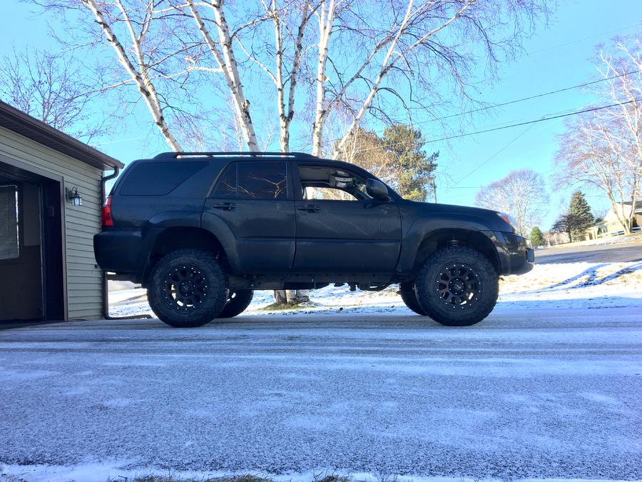

All in all I have to say I love the look and the ride. Now i just wish I could find a way to take pictures that do justice to the actual size of the car
Moved my drivers side fender liner foreward about an inch and a half, trimmed the passenger side some more so I seemingly have completely eliminated rubbing, even and full lock in reverse. Also disabled my tpms system today since the light has been flashing in my dash since before the lift was installed due to bad sensors. I monitor my tire pressure closely enough that I don’t feel I absolutely need the system any ways.... hardest part for me was handling those small wires in the cold weather

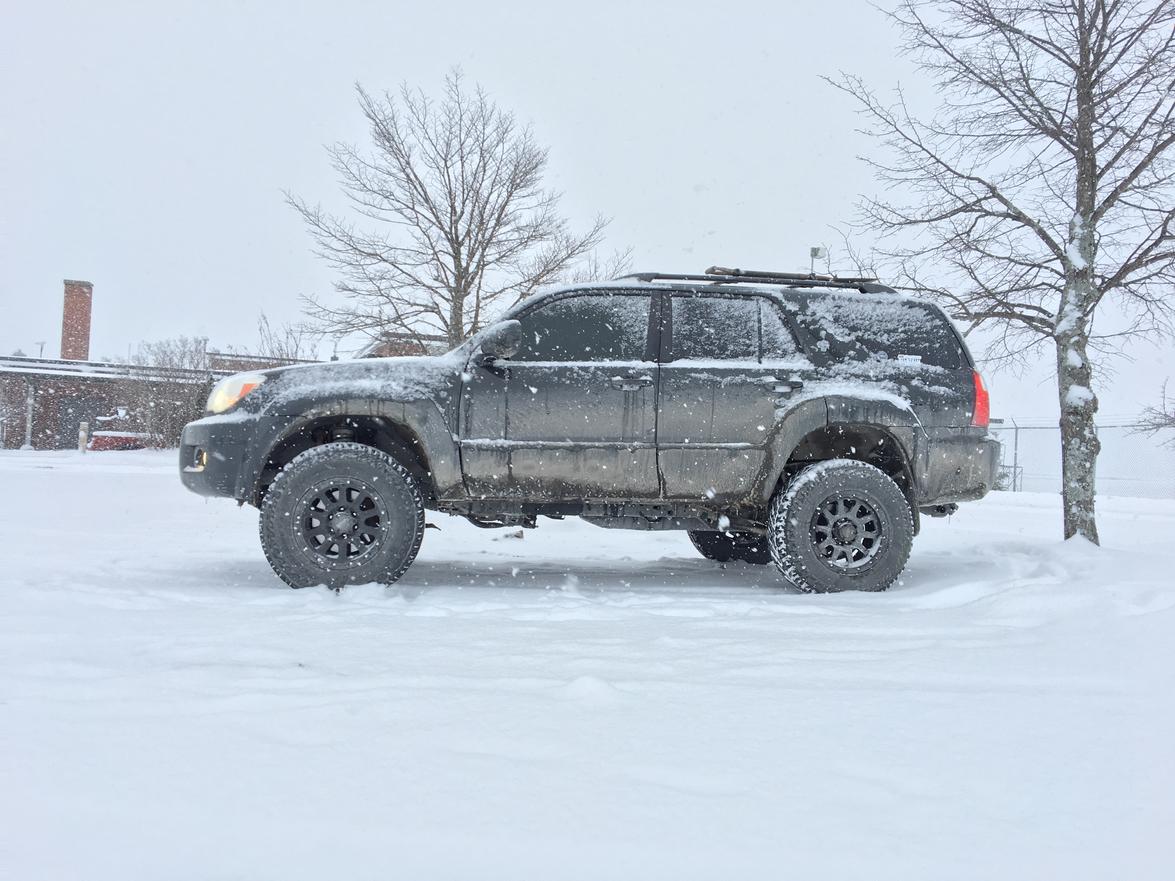

Got a nice picture taken in the snow storm we’re having here in Northern Maine
These Cooper tires I have are absolutely wonderful in the snow whether it’s hard packed on roads or powder or just a thin covering on the asphalt! I have total confidence in this rig but I know better than to be overconfident still.

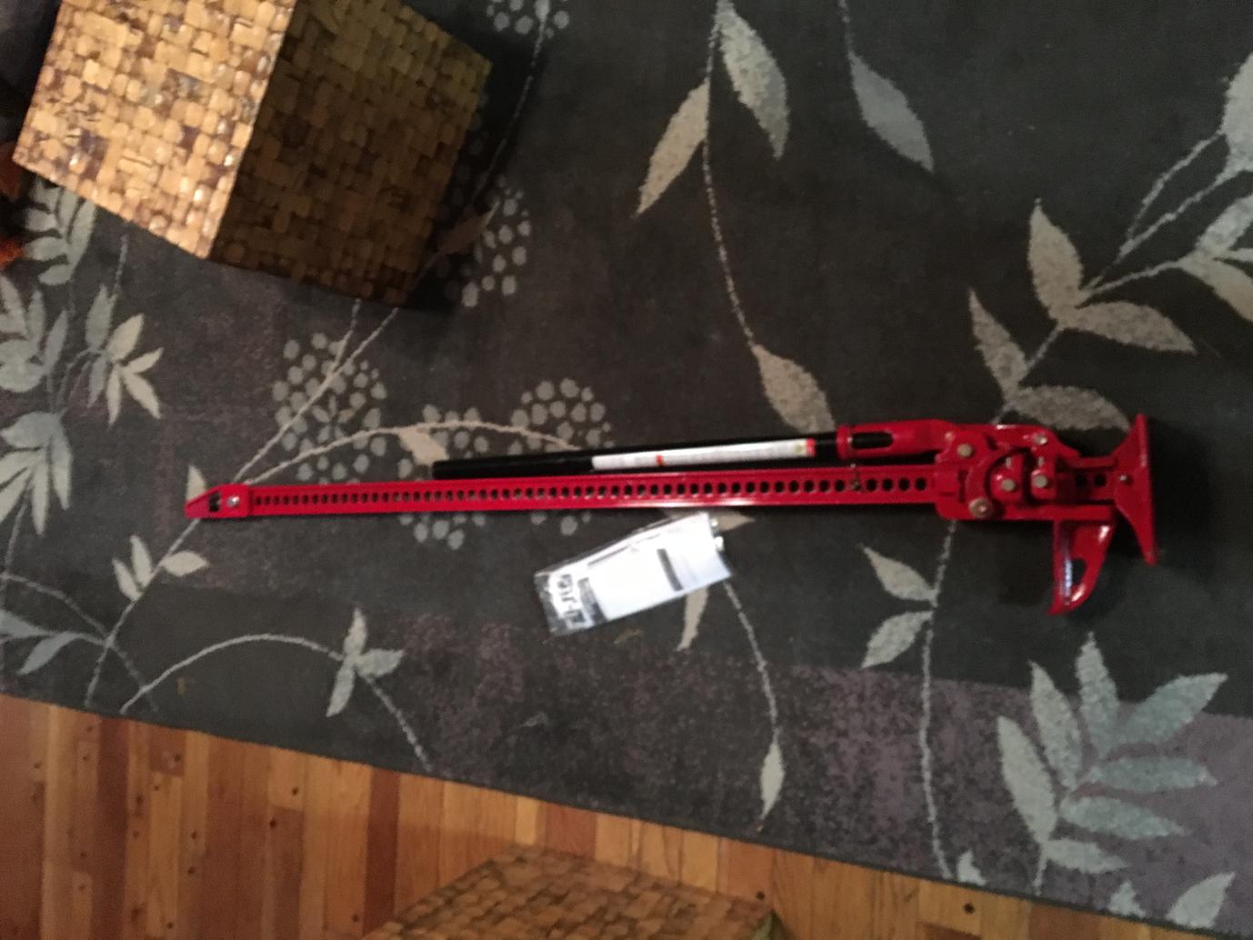

Got a 60” all cast hi lift jack as a birthday present today!
Now I just have to figure out where I’m gonna put it in the car... I know 60” is 5 feet and all but somehow I wasn’t expecting it to be this big :D

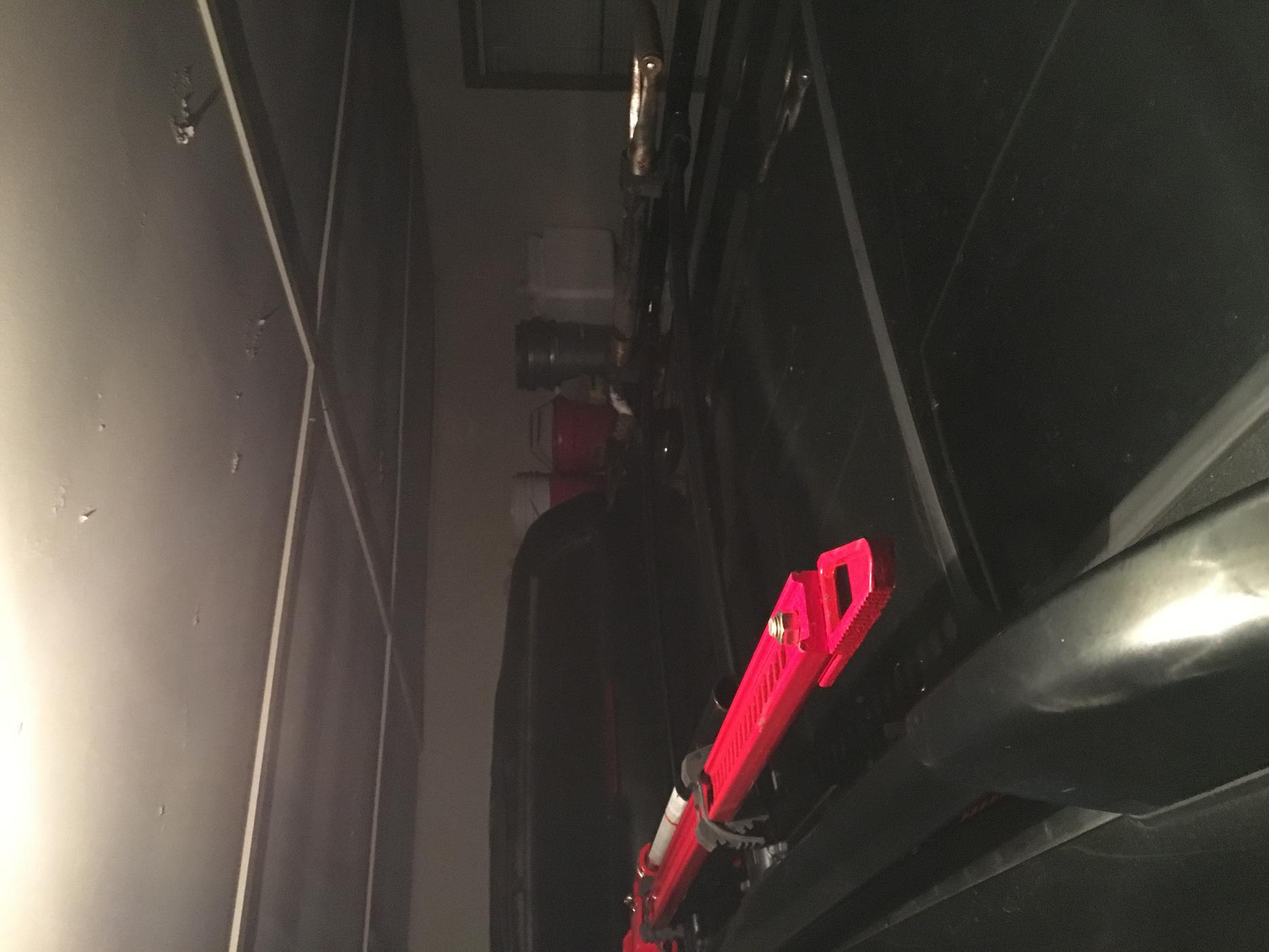

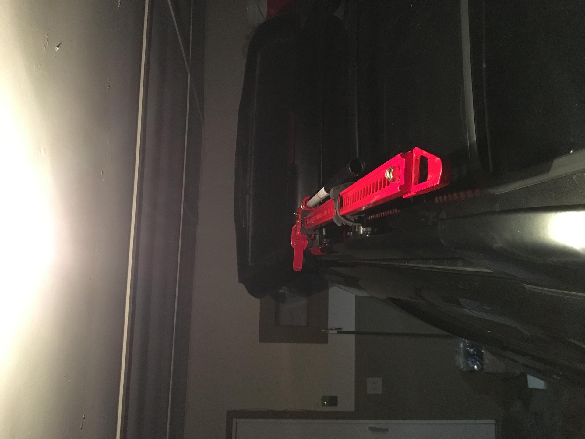

Figured out how I’m going to mount my 60” high lift jack on the stock roof rack!
I’m gonna is my set of Yakima 23h universal mounts and a set of quick fist mounts on the Yakima
If I take the base plate off the jack it will perfectly clear the roof
I’ll post up some pictures when I get the quick fist mounts in and everything installed
Not the greatest pictures ever because it’s dark out but I got my 60” hi lift jack and a shovel mounted to my stock roof rack by attaching the standard size quick fist clamps to yakima 23h universal mounts
The hi lift has the base plate removed and fits perfectly or this way
All I need to do is order some specialty 10” or so long u bolts so that I can secure it a little better from the average joe who may come along and decide it’s a good looking jack and also make it a touch more stable on the top of the car
Also need to get a sleeve to cover the mechanical portion of the jack since the roads up here get so nasty
Shovel I’m not so worried about security so I’ll just be leaving it how it is in the quick fist mounts
