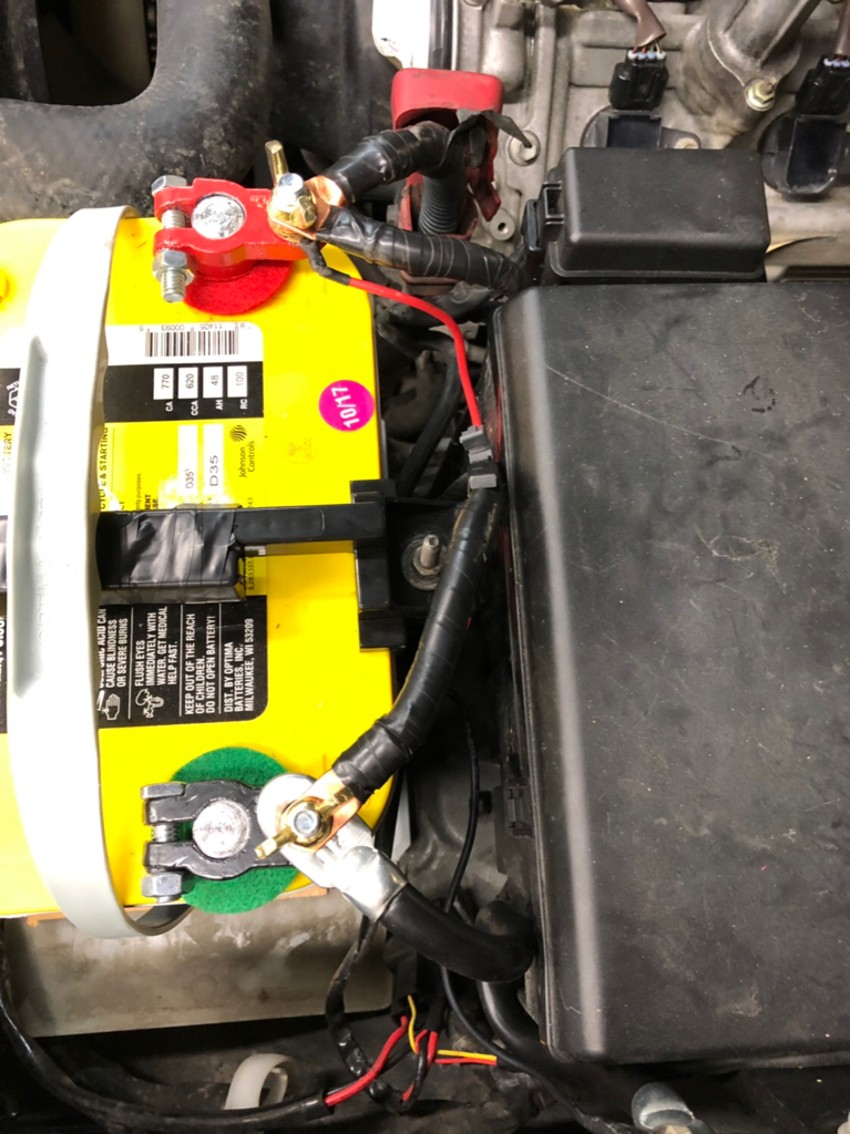

My battery stopped charging earlier this week, I picked up a new optima yellow top 35D for the car hoping that would solve things since my old battery was going on 7 years. Didn’t solve things, I was driving on the interstate and watching my battery voltage In the brand new one drop quickly so I got to the closest Toyota stealership at 6:30 last night and 7:30 this morning I was quoted $850 for a new alternator. I know I could have gotten a better deal elsewhere but I have finals coming up next week and can’t afford to gamble on my car...
I know that the 35D doesn’t have the best cca especially compared to the oem size, but I shouldn’t have any problems with it being in south Florida, right?
Over my winter break I may look into the big three upgrade I’ve seen mentioned here...

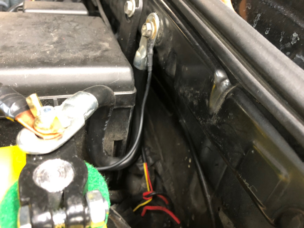

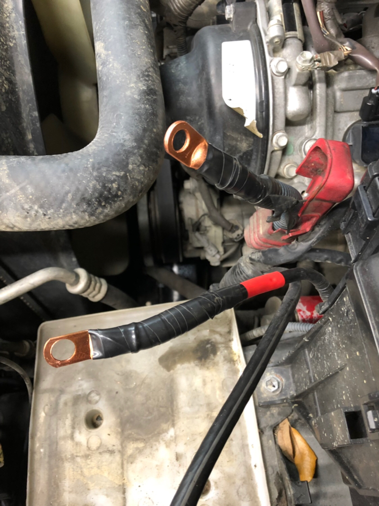

Then I stopped by tractor supply and picked up some battery terminals and copper connections and a 1 awg 12” black wire to replace my battery to ground connection
Just doing that power upgrade seems to have made my idle voltage jump from 12.6 to 13.4V

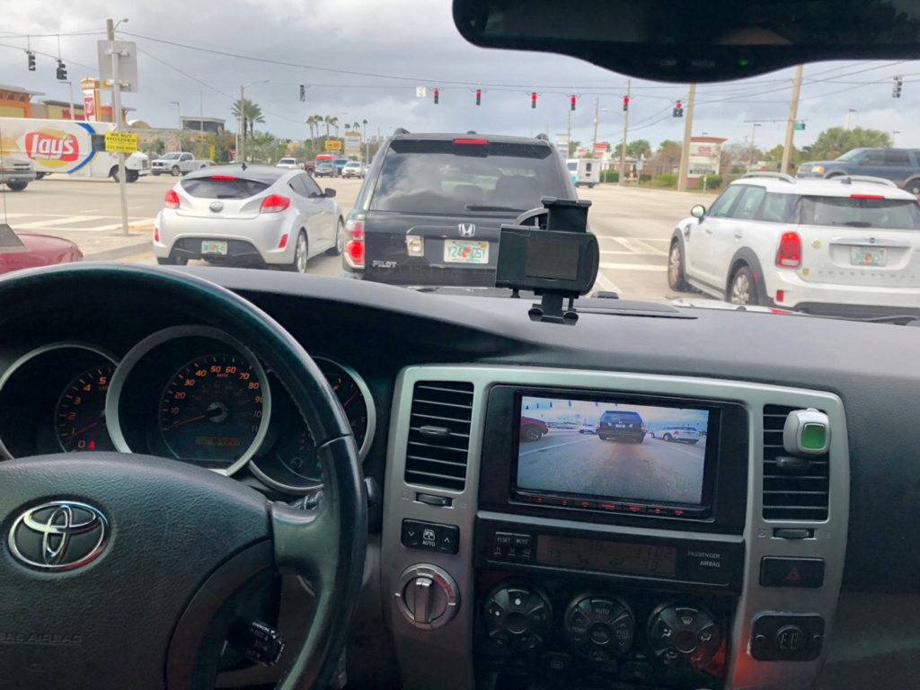

Then I installed a $17 camera from amazon as a front looking camera for things like parallel parking. The sellers claims about 170 degree viewing angle and I would agree with that

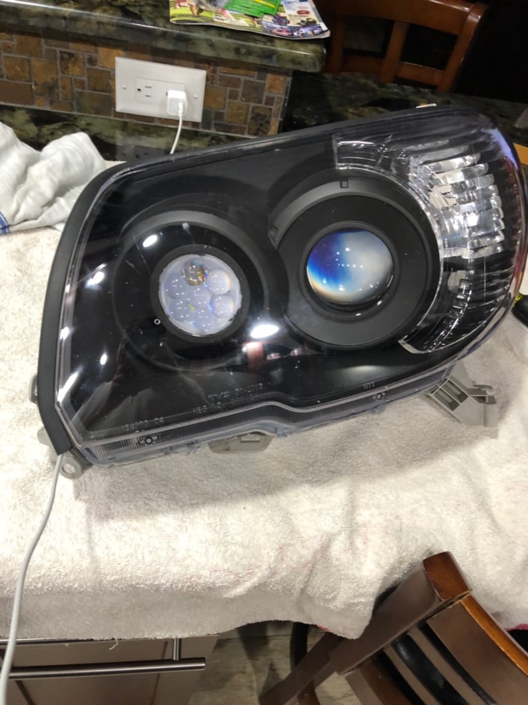

Just placed my order for all my headlight goodies. I will be doing a D2s 4.0 low beam retrofit with TRS Profile Hi-lens led high beams and all will be painted black
I will update with pictures when I receive everything

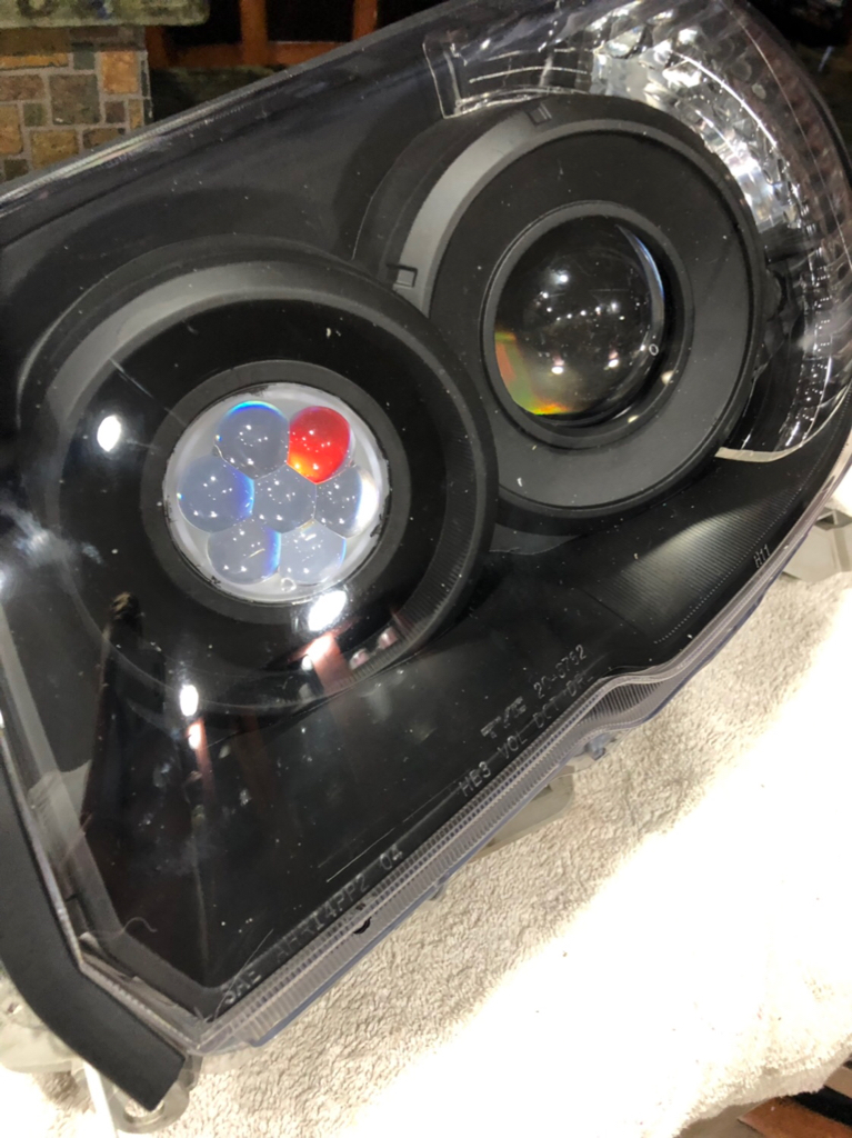

Finished up my headlight retrofit- this was my first time doing one and I’m very happy with it overall
I bought $80 tyc replacement headlight housing units for “parts” mainly just the lenses since mine were badly fogged over but I also ended up having to grab the plastic nut that the one of the adjustment screws goes into
I used gray retro rubber to seal the lights back up and then put some waterproof silicone Around the outside to be extra sure. I haven’t been through a car wash yet but heavy rain has caused no water to condense inside the headlights
For the build parts I used morimoto D2s 4.0 projectors and and trs profile hi lens led units to go in my high beam slot and I have the lights wired to use the D2s for low beam and then the D2s high beam and profile hi lens for my high beams when I turn them on
I used krylon matte black spray paint and I was rather liberal with it.
To mount the projectors I used a lightwerkz metal mounting bracket and the profile hi lens threads fit right through the hole for the bulb.
I did have to dremel the projector shroud from the oem housing considerably to get it so that the light would aim properly and in retrospect it would have been easier to buy separate shrouds to use instead
In terms of dremeling out the housing, is that to give clearance for the 3" lens compared to the stock 2.5" projector? Separate shroud just to cover up the dremeling, or??

Yeah the back side of the black painted housing was contacting the projector lens when I was trying to aim. (thankfully I decided to make sure everything would aim BEFORE I sealed the housing up) but if I had bought shrouds I feel that I would have been able to just make a more open cut and use the shroud to mask the hole a little better

Makes sense. Good to know!

I'm assuming you dremeled the projector hole on the shroud open for more clearance. How much did you have to take off? Doesn't seem like too much? Mine are hitting the shroud hard for upward adjustment, I'm gonna have to take a decent chunk out I think.
