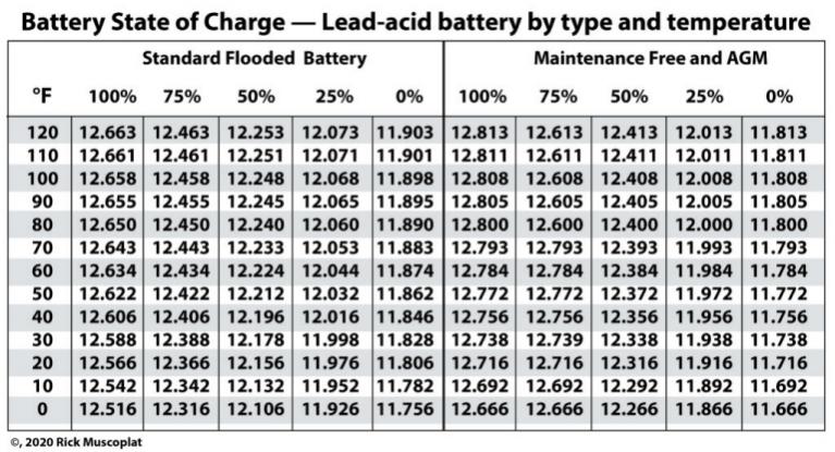

Batteries are affected by temperature. The lower the temp, the lower the charge will be at 100%. Anything below a 50% charge is a deep cycle and can damage the battery.
The life of a lead-acid battery is impacted by several things, starting with the quality of the battery. My '04 V8 came with a group 27 Panasonic (You can't get these in the US for some reason). I still have that battery and it still holds a 75% charge after almost 21 years, although I swapped it out after 12 years. I've had other Toyota brand batteries (Interstate) that died in 3 years or lasted 8+ (The replacement for the Panasonic in my T4R. Two batteries in 21 years.).
Batteries are either for starting or providing electrical power over a period of time, like an RV, travel trailer, bass boat trolling motor, etc. Cars need starting power; a lot of available amps for a short period (starting the engine) This is an ignition battery. Power over a long period of time is typically a low amp draw. These are deep cycle batteries.
A 'cycle' is how far down you draw a battery before recharging. A starting battery gives up a lot of power when starting but that power is almost immediately replaced by the alternator. That's a short cycle. A trolling motor battery on a bass boat will pull amps over hours without a recharge. This is a deep cycle. Deep cycle batteries are built for this. Ignition batteries aren't. They're built to provide that high-amp kick and deep cycling it will shorten its life. Let a car sit for 3 weeks at a time without starting or using a battery tender and you've deep cycled it. Sit and listen to the car stereo with a large amplifier and big speakers for a couple hours and you've deep cycled the battery.
Another thing that will shorten the life of a lead-acid battery is to let the water get low and not cover the plates. AGM batteries are completely sealed, so it's unlikely they will lose water. Non-AGM batteries, even "maintenance free" batteries, can lose water, especially if the charger isn't working properly. The charger will just boil all the water out it.
So a number of things can impact the life of a battery. One thing I've learned is to keep them charged. Boats are notorious for being battery graveyards. Owners park them in the fall and then wonder why the battery is dead in the spring. Something that impacted my wife's car was when we went on an extended vacation for 3 months. Her almost new battery was stone dead.
In my boat I added an onboard charger. It provides 3 independent 15 amp charges for the 3 batteries. I put it on a timer for 20 minutes every morning and afternoon, to simulate driving a car to-from work. On the wife's car, when we go on long trips, I put a timed charger on her battery; works wonders. I have 5 spare batteries in my garage, all on a timed charger.
Buy a quality brand battery, do the maintenance and they'll last you a long time.

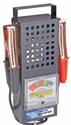

Anything below about 12.3 volts won't have enough amperage to start your car. Harbor Freight sells a battery load tester that will tell you the strength of the battery under a load. I have this one and it does a nice job, simple to use, $20.
Battery Load Tester
To test a battery to see if it will hold a charge, charge it up according to the battery charger's instructions. When turned it's off the battery will be 12.7 -> 13.1 volts DC. Let the battery sit for 2 hours, then check the voltage again. If it falls to below 12.5 it's not holding its charge and probably has 1 or more bad plates.
Taking the battery down to 11.3 is very deep cycle and most likely has severely damaged the battery. It would depend on it's quality and age to say for sure how much of an impact, but its life is definitely shortened.
When batteries are fully charged they won't freeze until it's below -76°F. A discharged battery will freeze at 32°F. Electrolyte is 25% sulfuric acid, 75% water. When fully charged those 2 mix but when discharged they don't and the water will freeze, cracking the case and damaging plates. If you attempt to charge a frozen battery it will explode and spray acid. Any water outside the battery won't have an impact on water inside the battery.
